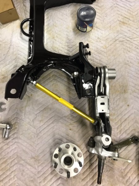

Have a loop welded into the front of the K-frame, and a pair welded to the rear of the rear frame-rails.
i went around the rear axle before (wheel side of the shocks). now i have the plates that go under the shock plates. will be much easier now.. front i go around the lower control arm.
