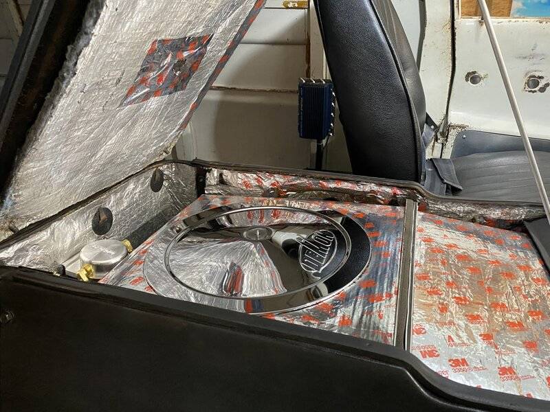

And clean as heck! Hey 12, how much room is under the doghouse?
Room? Hah! Just enough for a fabricated cold air box using a 14x3 air cleaner assembly , the wing nut rubs on the lid just a tad.

Actually my air intake setup works pretty good, the engine gets more than enough cool air. I recall someone mentioning here on another thread about just building more power vs. gutting and extreme weight loss. I’d say the same about extreme aero tricks. Just build more power.
