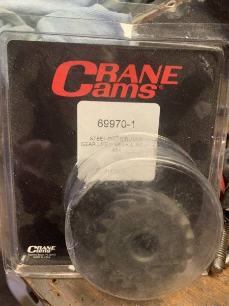

I did not ask if they had tried it. I'm going to roll the dice with you, I'm putting the crane gear on and it will be what it will be.

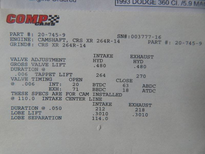

I agree with the billet stuff. Just took a look at the cam you mentioned in the other thread...comp 20-745-9, correct? Its a XR264HR-14. Comps specs say it´s a billet steel core…..but honestly i think this is plain wrong! I do have the XR286HR-10 here with me, believe me it´s a cast core. Why would a manufacturer use a more expensive material in a smaller cam? Do you happen to have a pic from your cam?
don´t want to bother you, just trying to clear something up.
Michael
If it is me your directing the question to, no bother, but IDK why that would be. Perhaps a question for the grinder themselves?
Michael
I don't have a picture of it. My cam is in my van.

here it is, the comp hydraulic roller / cast core i mentioned. That´s the reason why i still believe that the one in the van is the same cast core...and compatible to the stock oil pump drive.
Michael
any chance you´ll pull the Distributor to check the cam and make a photo?
I wonder about the grind#, the "H" for hydraulic is missing. At least this is the way i know to read the comp grinds. But the Valve Adjustment says hydraulic…..weird.
