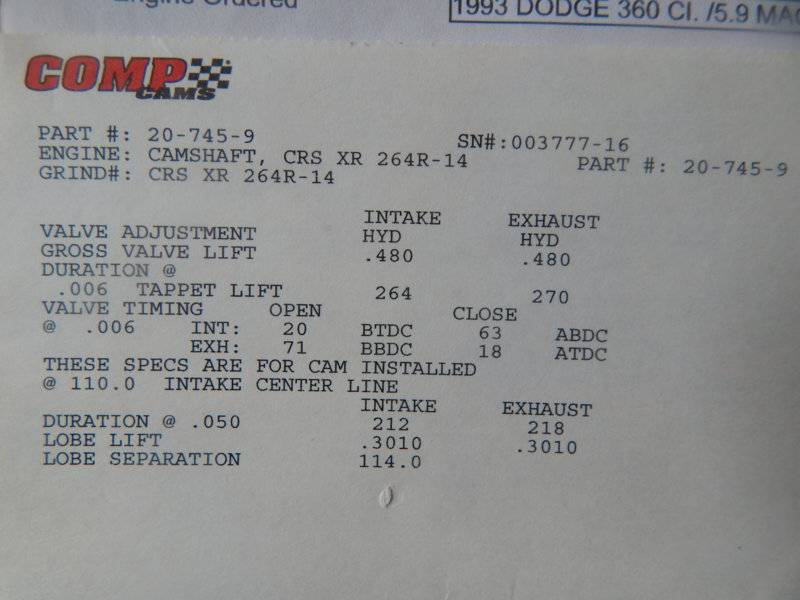

Comp web site says this is billet. here is the cam card...
Where does it say that PN is billet? The Comp website for that PN doesn't say billet for me, and photos that are supposedly of that PN don't show a billet part, but a cast core. Is it really a billet core? Seems like it's time to try to sneak a peek at it.

An actual pic of the Comp cam in question would quickly answer whether or not it was billet.
20-745-9 is a hyd roller with the short magnum snout.

I agree with the billet stuff. Just took a look at the cam you mentioned in the other thread...comp 20-745-9, correct? Its a XR264HR-14. Comps specs say it´s a billet steel core…..but honestly i think this is plain wrong! I do have the XR286HR-10 here with me, believe me it´s a cast core. Why would a manufacturer use a more expensive material in a smaller cam? Do you happen to have a pic from your cam?
  • It says its billet on the link you posted. Click on "specifications" and it says billet steel.
