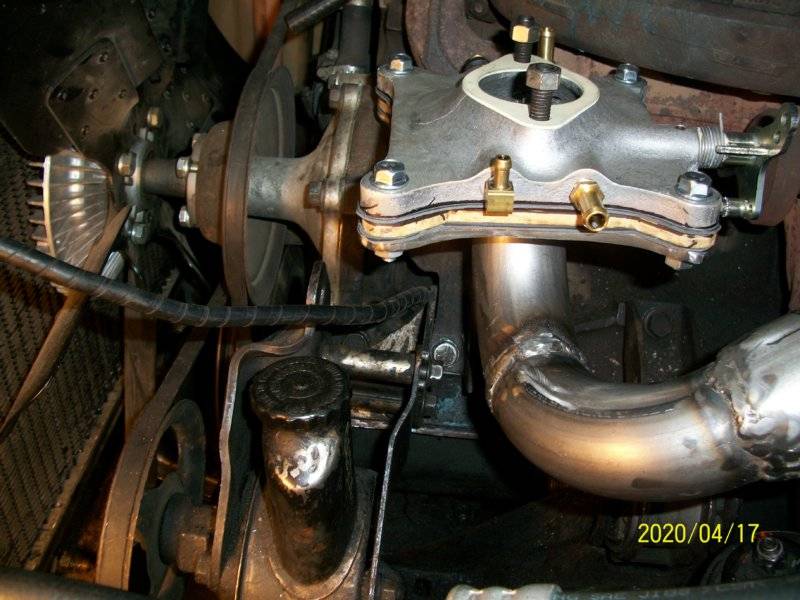

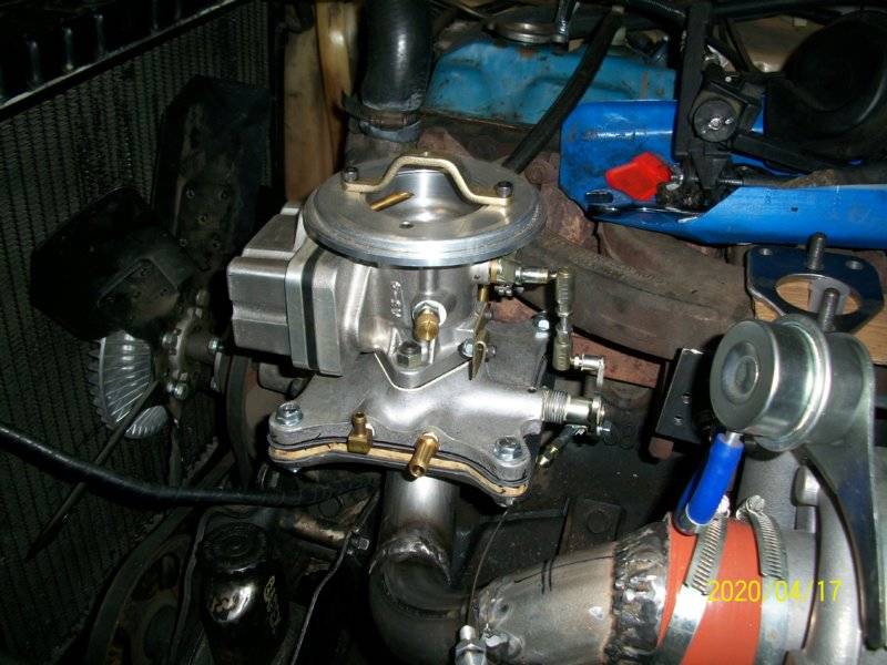

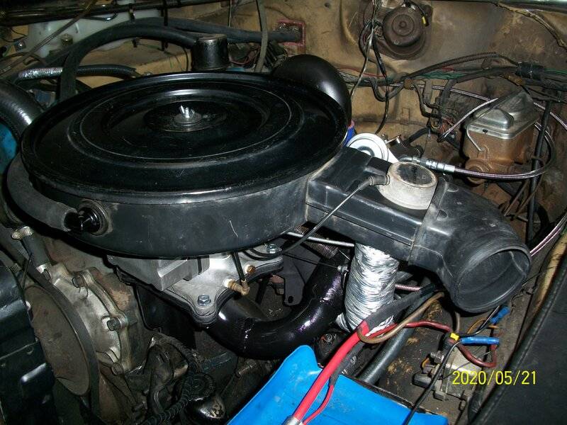

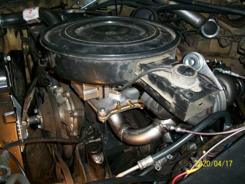

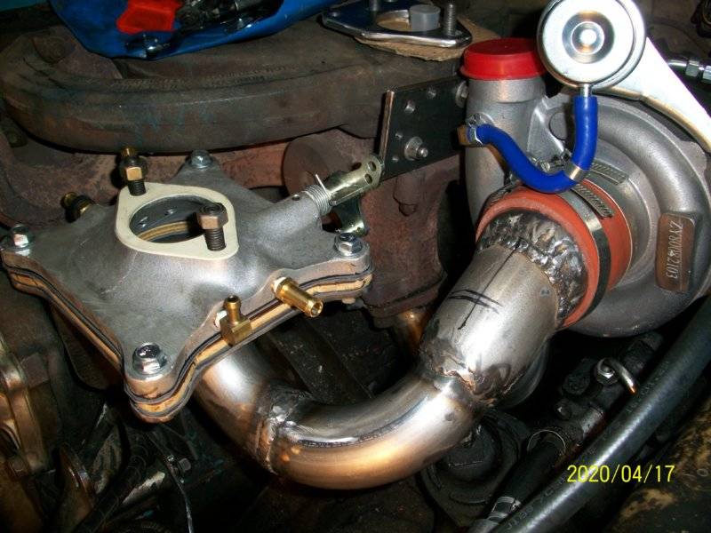

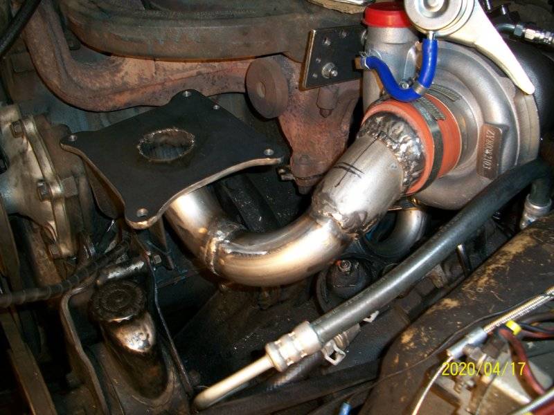

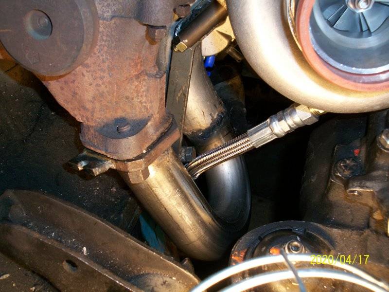

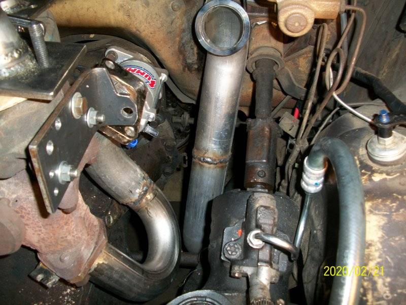

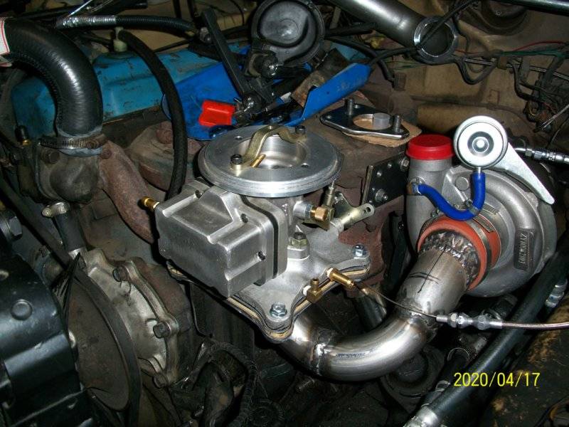

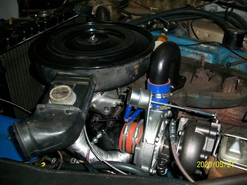

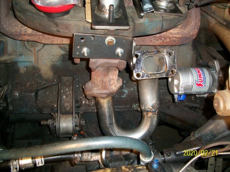

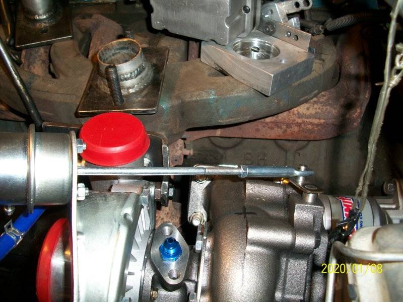

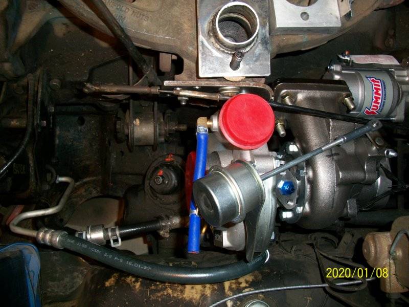

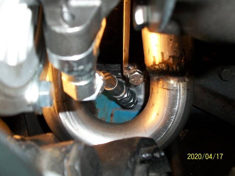

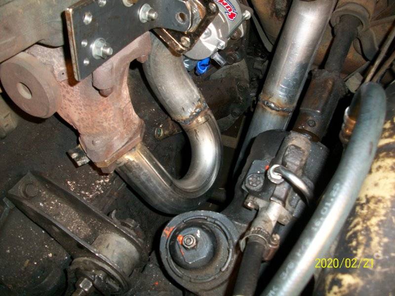

Photos are of 225 slant six, Fish carb, draw thru/suck thru, almost there. Photos show progress in steps. Not finished. Lacks 180 to intake manifold. Needs hot air system for air cleaner. Fish is 1 Bbl. It all fits under the hood. Enjoy wondering.
Isn't your "Fish carb" rated for about 1300 CC and a slant 225 is about 3700 CC?
Would like to post more photos, but the site says they're too big, even one that is smaller than the last one posted. Anyway, final mock up was attempted to post. Imagine an inverted "U" pipe welded on a flange to the intake manifold, from the turbo compressor connected with a blue hose at the compressor with 2 hose clamps. Not visible are the trans cooling lines passing to the left side of the steering box to the shortened steel lines from the trans.
Final installation. Missing pressure gauge and broadband gauge. Next step: start up and run through heat cycles, wrap with header wrap, tune. Air cleaner assembly is stock four barrel off of Dodge van. Almost factory appearing.
