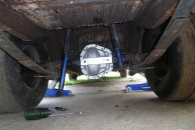

changed the rear to a 3.55 > Yep a 8 3/4.....lol
until I figure what gear for the Dana
Still need to remove the tamper collar for the power screw

You just need to buy a gear vender and your problems would be solved!! LOL
It will turn them 3:55 into 2:77 just like that!
Gear Vendors under/overdrive auxiliary transmissions Hot Rods, Dodge 3-Speed Automatic Muscle Car/Street Rod/Restoration.
could be cheaper than finding a Dana 61 and then gearing it.......................
IT'S ONLY MONEY!:poke::D

gonna put the 518 trans in with a 3.73 or 4.10
I have a Dana 61 > 3.07
might try 3.23 in a few weeks, or even a 2.94

I would skip the 518 and go straight to the 61 w/307!
