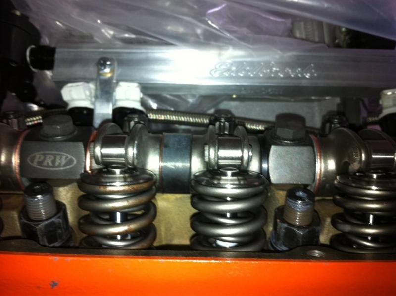

Not wanting to be the bearer of bad news but is that rust I see on that valve spring? I have read / seen somewhere that you should only handle springs when wearing cotton gloves to keep the acid from your skin off them. Hope they will be OK.

Rust? no those springs are Brand New from Comp, assembled by IMM. I poured oil over the top of everything after I installed the rocker gear, the picture is a day or so later. I think MRL had Comp make him a set of Lifters just like the ones in my engine that Brian at IMM Sold me. Brian has had those lifters for quite some time before any of the other players.

Just saying about what I thought I saw on the valve spring. Might just be the photo. You do not seem to be the kind of guy who cuts corners or does things any way but right.
http://www.compcams.com/Pages/415/truth-about-valve-springs.aspx
