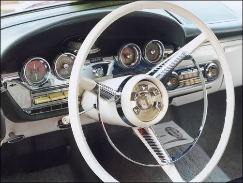

There's always Edel...............
Whatever this thing is....
https://aftermarketpress.com/index....e-automatic-s-smart-shift-push-button-shifter
http://www.lsxtv.com/features/sema-...ps-a-push-button-shifter-for-any-transmisson/
Ha.. those buttons controlled 5 or 6 solenoids on the firewall.. They were "un-available" back in the 70's,.. I had to take two of them home one night, and hand-rewind them,, to get it to shift... Edsel.. sheeesh..
