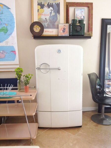

There's a 1949 Kelvinator in my basement that came with the house. When the last "main" fridge in the kitchen let go several years ago, I plugged it in and discovered that it still works. Quiet? No. Cold? Yes sir, and that's what mattered most at the time. I replaced the kitchen fridge in a couple of days (it's an odd size) and shut the Kelv down soon after.
It's got a rounded top, "kid killer" latching door with a huge chrome handle, extruded-aluminum hinges, chrome emblems on the door... if it didn't work it'd become a storage cabinet. It's too cool to let go. I'd love to restore it with more modern (quieter) internals and perhaps a Mark Donohue AMX paint job (after all, it is an AMC).
It's not this nice after years of neglect, but looks like this one:
