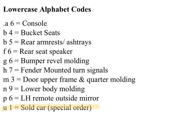

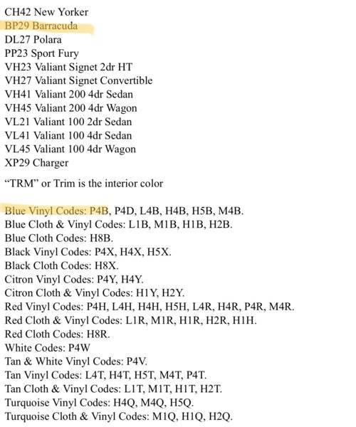

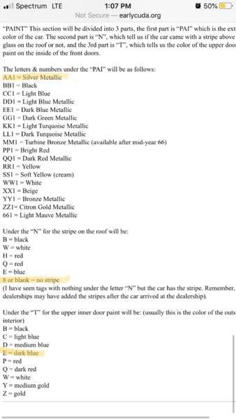

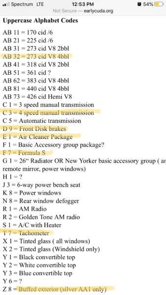

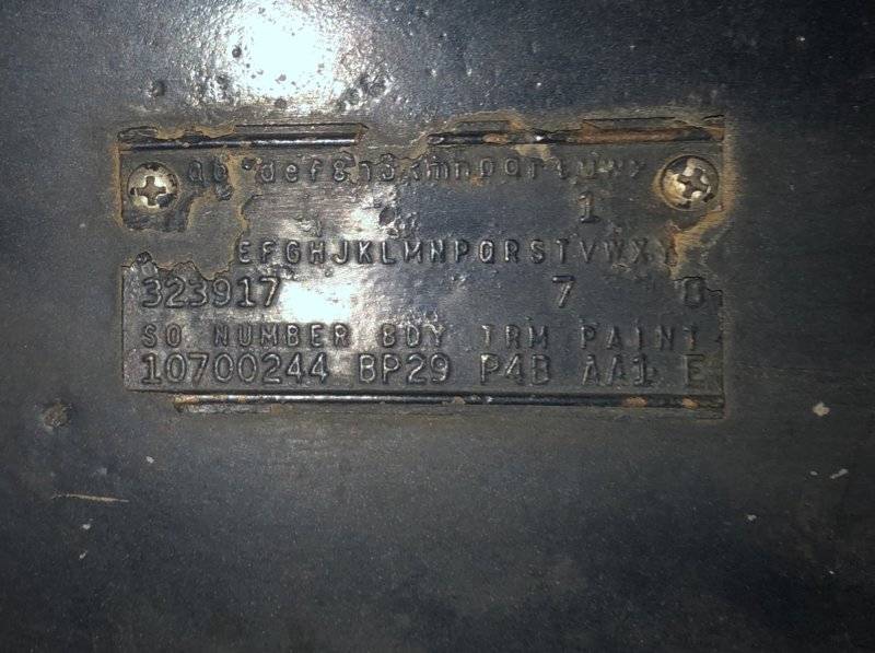

Alright, here we go. I did more research and found this website that details the decoding process for the 66 fender tag. According to the tag it is a real Formula S car. It’s so cool to find out all the original options!
