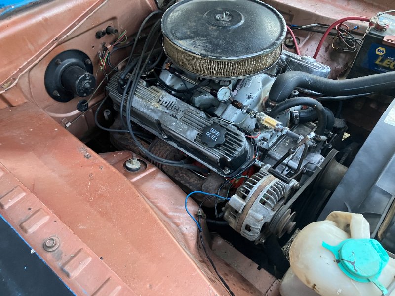

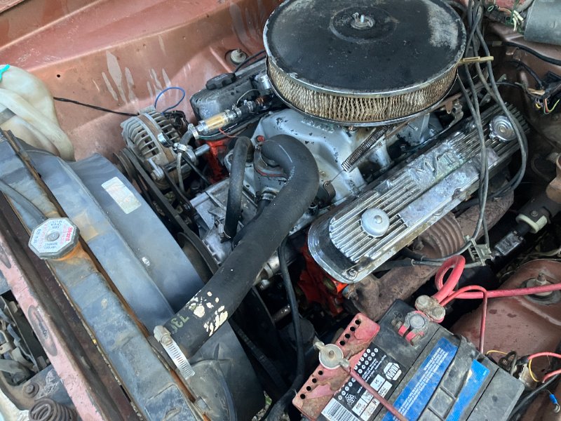

The '76 360 of mine has been in my 67 Dart since 2006:
This is a standard bore mill with #308 heads and Fel Pro gaskets, maybe 8 to 1 compression. It has a MP 280/474 hydraulic cam, 1.5 rocker arms, a Weiand intake and Holley 750.

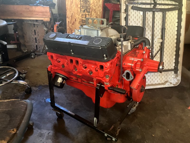

A friend wanted to unload a 360 he had....1990 roller cam engine with 2 blown head gaskets. I went through it...new pistons, rings and gaskets but I retained the cam since it is a Hughes with 218/228 degrees of duration and .544 lift. It has an Air Gap intake and will use the same Holley carburetor but with 1 5/8" Dougs headers.

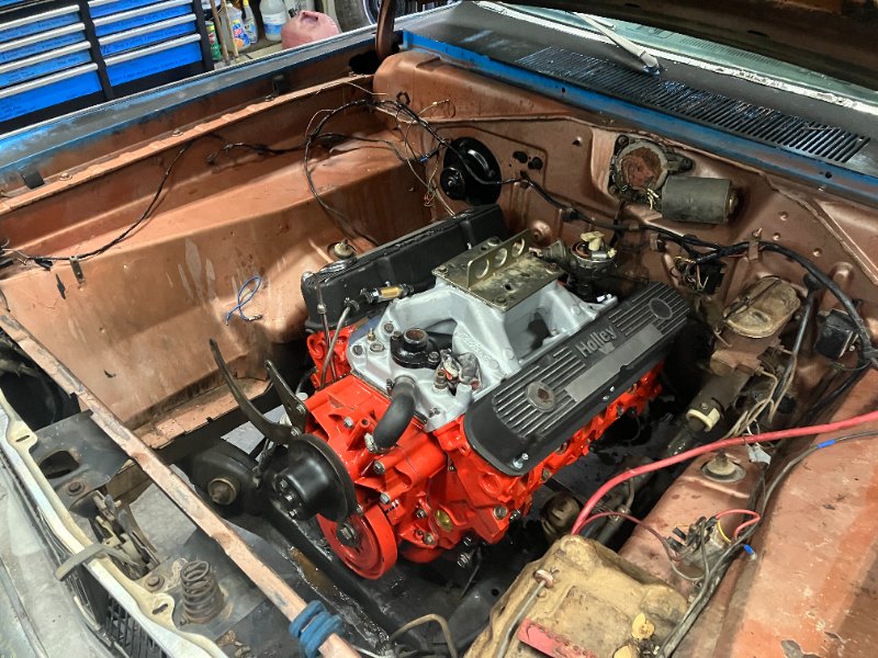

The '90 engine is in and I'm still finishing up with it but I'm curious about how the two will compare in performance. I'd expect the fresher, higher compression engine with a better intake and exhaust system to run strong but the difference in duration and lift has me unsure.

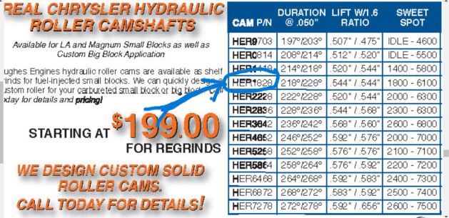

the hughes cam is actually 218/228 @ .050 while the advertised duration is more like 268/278, so it got quite a bit more lift than the 280/474 MP unit.

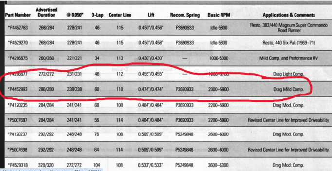

The info I've read is that the 280/474 is rated at 238 degrees @ .050.
The Hughes cam I have:

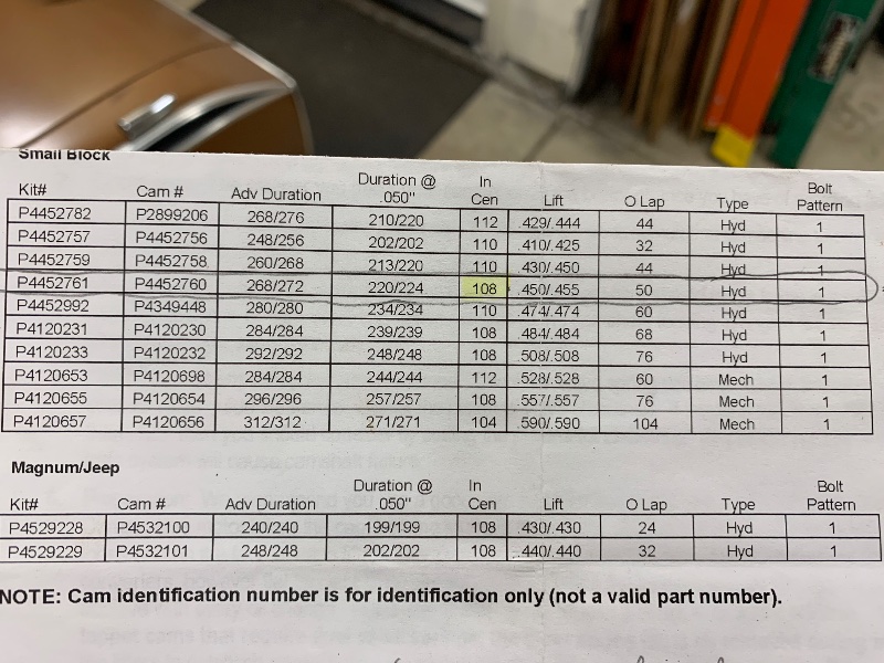

The duration at .050 in the first chart is just the number you get by multiplying the advertised duration by .85. Not accurate, not sure why Mopar Performance ever pushed that. The chart below (which I think I might have got off this site) I'm pretty sure has more accurate @.050 numbers:

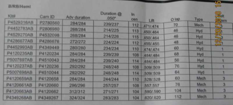

That was for small blocks. Here's one for big blocks. Probably from the same source.
I've come to realize they pushed the 850 figure and didn't use it. They used "somewhere" in between the 777 standard everybody else used and 850. Because when you do the math, none of them math out using 850. I am almost 100% certain they did that for proprietary reasons. They simply did not want people to know their camshaft formula.
