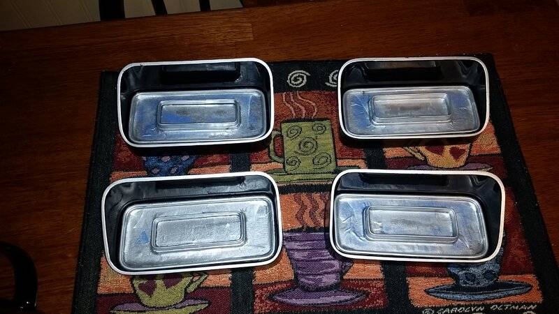

A really good tape job. And spray it. But use pin stripping tape around the paint edge first.
Tape off all the silver. And spray the black. I'm guessing the silver is polished something? Find the widest pin stripe tape you can for the edges. And just blue tape for the bulk of the tail light. Start a small section and post it before you go hog wild on it. I'll walk you thru it. Get a brand new X-acto blade just for this job only.
Oh I'll take the bezels off like I did with my front, and its anodized aluminum like the front as well.
Its easier to take them off and tape, not worry about taping the lenses. I bought one of them fancy exacto knives, it worked really well on the front.

Thank you and yes I'm liking it, my wife said my face lit up when she sent me the edited before and after pictures..
I'm going to polish the aluminum and trim some more and then I have some Sharkhide Aluminum coating coming on Sunday and I'll cover everything with a protective coating.
