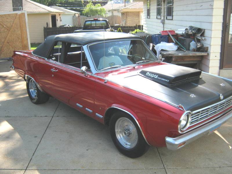

update :
I think I'm going to rebuild my 273 engine . I bought the crank and rods already and so I'm going to use them. the rods are lighter so that may help it spin up a little faster and advance the erson up 8*. I've gone thru wanting to go fast back in the past , so that is out of my system . I had built a 360 crate into a 65 dart convertible years ago that when 11.4 on motor and dipped into the 10's on squeeze ,and other 340/360's, so I have been there /all done that . My 65 barracuda is a real formula S and I don't intend to start butchering it up. It's just a stock driver and it's fast enongh for me and it's a blast to drive . just say n.
I appreciate all your opinions and help you guys , I'll just keep tweaking on it . I'm just having fun . Hope you all understand .
