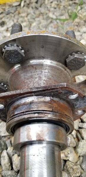

What would cause my barely used green bearing to do this?

I installed these dutchman axles a few years ago, and they have very few miles on them. I pulled them out today to replace the pumpkin, and this is what I find. What in the world would cause this? This is just the one axle.

The one and only time I have seen green bearings look like that was because the button wasn’t removed first.

They look kinda dry, what grease were you using?

When you installed them did they slip right in by hand or did you have to force them in?
Insufficient end-play .
Shims are avail.
Some after-market axles come " trim to fit " .
As per post #18 .

Because the green bearing, if installed correctly in a straight housing is just as good as a tapered bearing without needing to bother with adjustments. They are simple and they work.
Someone erroneously made the Ford comment. Ford.....and others have been using the "green" style bearings since at least the 1950s and in some really heavy duty applications. Even though I prefer the original style tapered roller, there's nothing wrong with the green style bearings just because they are that style.
Unfortunately, the original Mopar Green wheel bearing design has 2 problems.
First generation (RP-400) Green bearings, still sold by Mopar Performance and others, are problematic because the crimped-on flange will not allow the bearing to wiggle around inside a housing that is not perfectly straight (none are).
In addition, the design causes the axle to be inserted DEEPER into the housing than necessary. This results in pre-loading against the differential thrust block and early bearing failure.
Second generation (MO-400) snap-ring style Green bearings are forgiving because they can move around inside the housing and they do not preload the differential thrust block in a stock application.
Most guys who have problems with Green bearings are running the RP-400 first generation version or incorrectly made aftermarket axles or housings or poorly designed rear disc brake kits, all of which cause pre-loading and premature bearing failure.
I have several customers running MO-400 snap-ring Green bearings in daily drivers. The design is no different than what came stock in millions of other vehicles, including ’60s era Mopar 7.25″ and Ford 9″ rears. (For example, see here) I do not stock, nor do I recommend the first generation RP-400 Green bearing with the crimped-on 5 hole retainer. I only carry the “loose fit, snap ring style” second generation MO-400 design.

In my experience the 1st Gen bearings didn’t last me long, probably around 1 year of use. I did remove the thrust block and the install was done correctly, including the pressing on of the bearings. Replacing the defective 1st Gen Bearing to the 2nd Gen bearing has lasted me over 20 years.
As far as 8.75 housings being straight in my experience making 451HP and 589Tq at the rear wheels, the axle housing does twist and become deformed. I can visually see spring perches bending, axle housing bending, kinking below the U bolts (especially on the passenger side). Transbrake, blower, nitrous, 3800 pound race weight big tires, etc....
We really don’t know what the OP’s installation process consisted of.......
With that said, the 2nd Gen Green Bearings are a better design.
