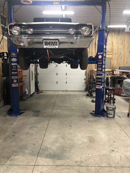

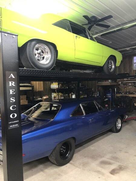

After all this, I am going two post for sure. Since I am going pretty big slab, I would have room for a four poster storage lift as well at some point, and probably will for the dart and valiant.
