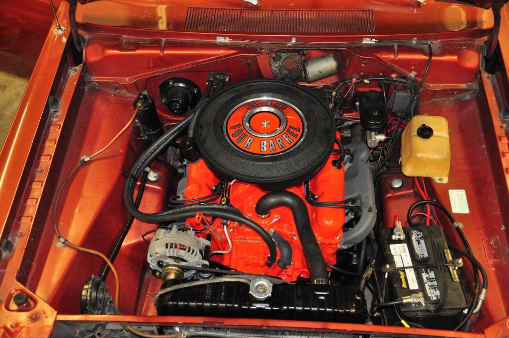

thats a wilwood one in this pic.. it has a different piston size then the billet one you are talking about i believe..
Ah, yes. I forgot Willwood sold those too. My preference was to not have the plastic tank. But you're probably better off with the one you got. The billet one I have s nothing but a pain in the ***!
