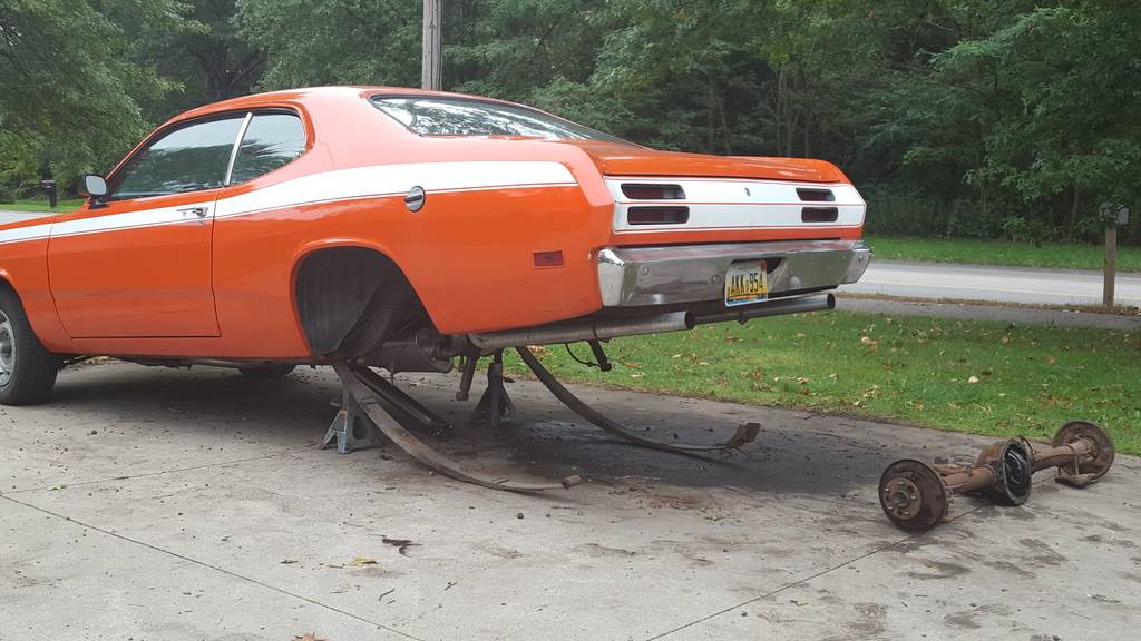

Oh yeah and I broke one in my first Duster and didn't even waste time with the one in my second Duster. I took that out before I ever drove it.
