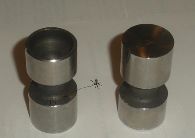

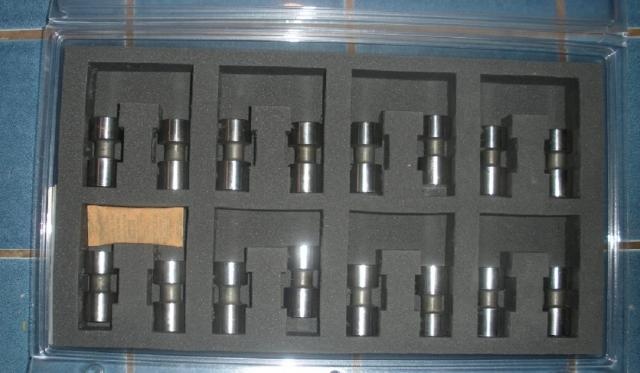

The EDM lifters are different. Check out the deep recessed section in the middle. If you look closely at the second picture, you can see the tiny oil hole in the recess. This hole passes through the lifter body and exits at the base, squirting a stream of oil directly to the cam lobes.

With the history of cam failures, wouldn't you think they'd include a bigger supply of cam lube??
Yeah....I'm going to buy more.
