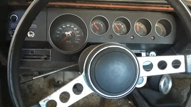

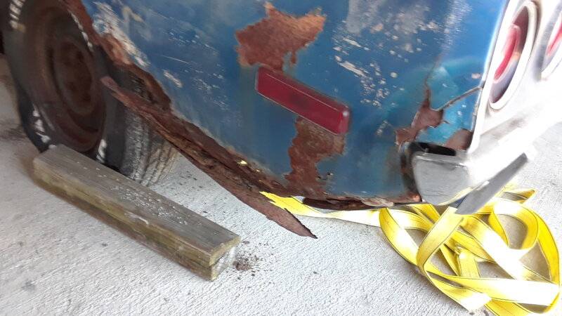

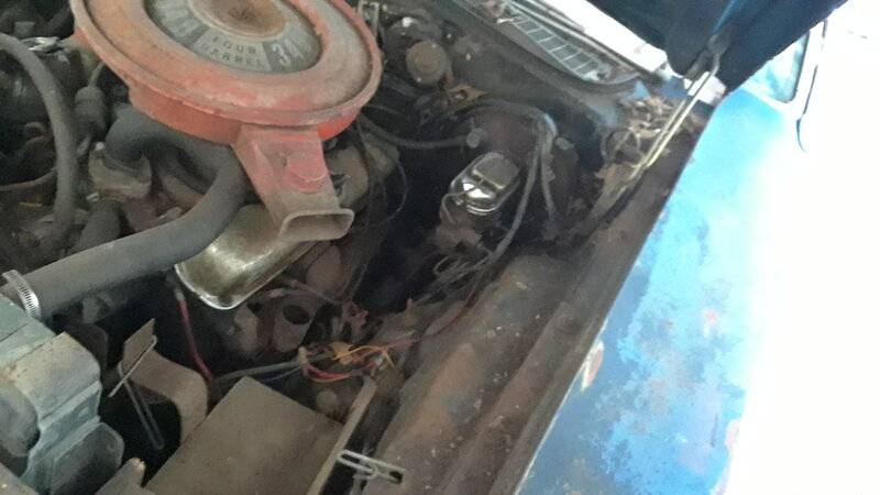

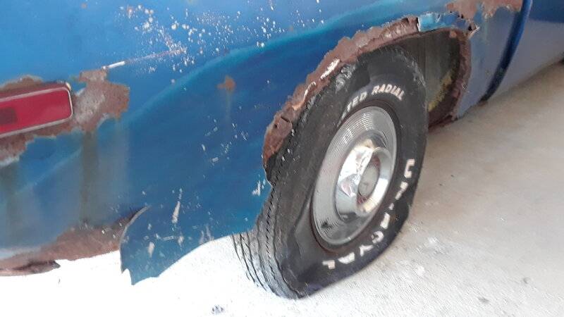

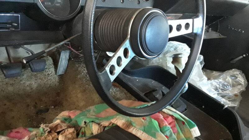

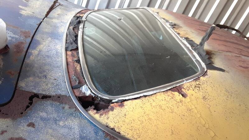

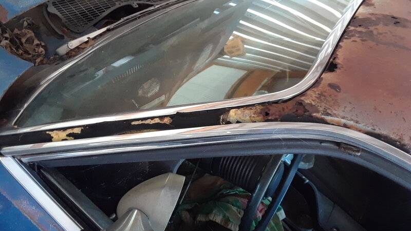

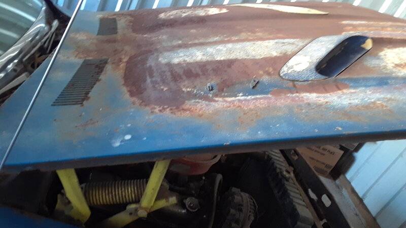

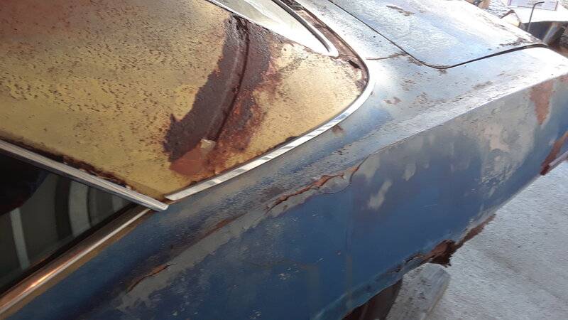

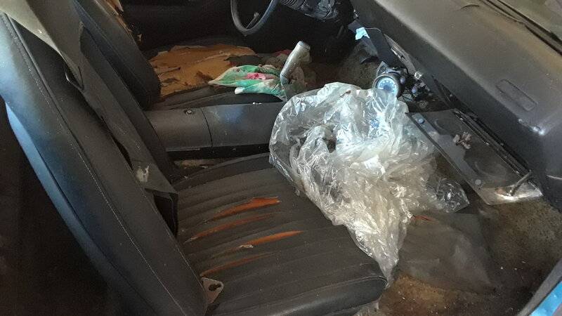

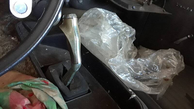

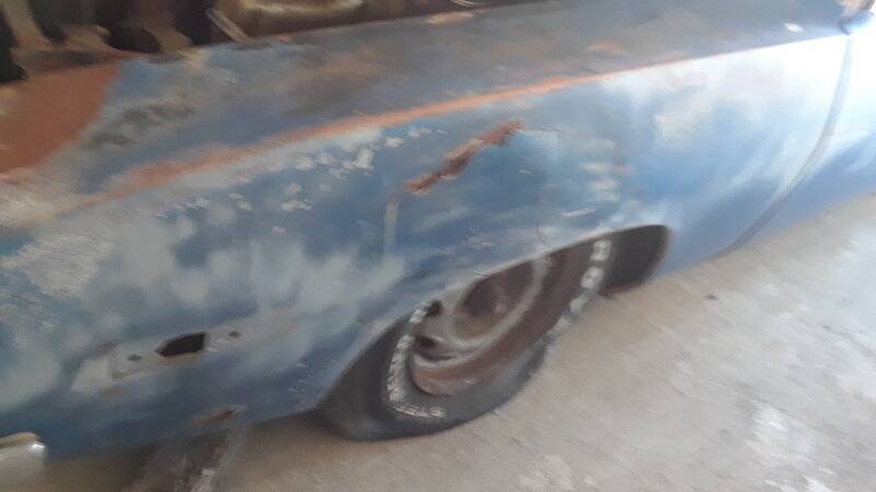

Good afternoon Sportsfans.
Shelia's a 340 Pistol Grip car. No fender tag, and I've not looked for a build sheet.
She's been sitting outside since around '85, and off of the road since about '89.
Should she be sold to someone that can restore her, part her, or???
More pics to follow.
Thanks for looking.

Go to AMD and start a list of the metal you can see is bad...
From the photos:
2 full quarter panels
Trunk extensions
Roof (need donor for the pillars)
Dutchman panel
Trunk lid
Metal around the trunk opening
Trunk floor
And I can’t imagine it sat outside 35 yrs with all that rot and it still has solid floor pans and frame rails. Looked like the bottom of at least one door is rusted. Is the body still solid at the door hinges? What about the doors? What are the valences like? Does the front end have bondo?

A 340 4 speed 'Cuda without a 150 speedo or rally gauges? Did they come like that?
I think in 72, they could come either way. The VIN should be either BS23H2Bxxxxxx or BH23H2Bxxxxxx. It appears to be a plain jane 72 Cuda 340 4 spd, that was originally Lemon Twist yellow. The OP needs to jack it up, put it on jack stands and see if the VIN stamped on the motor and 833 match the last 6 of the VIN on the dash, radiator support, and top of cowl.
