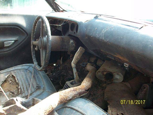

A 340 4 speed 'Cuda without a 150 speedo or rally gauges? Did they come like that?
Yes, the ralley gauges were optional on the Cudas, but standard on the Challenger R/T's

Here's a couple more pics. I plan on trying to authenticate the vin on the 833 & 340 this weekend. The door matches the dash. Where would the other #'s be?

Cowl # is on the top drivers side. You may have to wipe it with a wet rag to find it. Radiator support # is on the drivers side also, and should be on the back side of the support facing the radiator. There are no numbers in the trunk or package tray. Push in on the bottom of the back seat, and then pull up. You will need a ratchet, extension and some sockets to get the back of the back seat out. Been a minute, but I think it's either a 7/16 or 1/2 " socket. If you're looking for the build sheet, take enough tools to get the plastic backs off of the bucket seats. Sometimes they stuck them in the springs there. They usually fare much better than the ones in the back of the back seat. That car most likely came with the standard dash, because it only has 2 speed wipers. Rallye dash would have had a 3 speed wiper motor. $5K would be top dollar for me on that car, even if it was #'s matching. I sold a roller 74 Cuda 360 last year with the numbers matching motor, triple black with a NICE body for $9K. It needed zero sheet metal replaced. Kinda wish I hadn't, but I needed the $$$. :(
