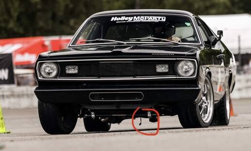

The best pics are above, because I didn’t take them! Ha! I posted some videos on my Instagram. Here’s a couple screen shots from a speed stop video. The RR has a big block (I think a big inch low deck block) and the super bee has a Gen 3 hemi. They were both really nice cars.
Looking good!
what you got dangling? Electrical connector?

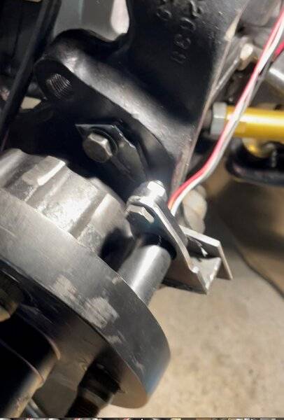

Below is the beginning stages of my bracket for the front wheel speed. This is a $40 hall effect sensor from DIY Autotune. I have it reading the back side of the lug studs. I'll do the same thing on the back. The late TKO500s have an extra hole for a speed sensor besides the speedometer hole. Unfortunately, I have an early one without this provision. There are hall effect sensors that take the place of the speedo, but I want a speedometer! If I was going with a digital dash, it would be a no brainer to use it, but that's not the case here.
So for $80, some scrap metal, and a little bit of time, I'll have traction control. Should be fun...
