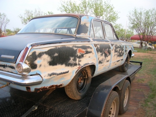

1965 Valiant 4 door.

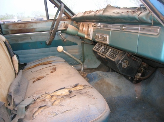

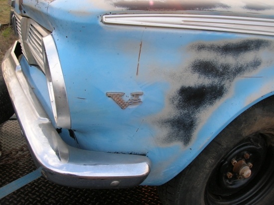

Here is my latest Valiant. It's a V-200, 4 door, with a 273, 2bbl, add on a/c, and a 4 speed! All the other cars I own or have owned are 2 door, but I couldn't pass this on up. The motor turns over and I am getting all the stuff to see if I can get it running. It was originally black with aqua interior.

Nice start.THANKS FOR YOUR SERVICE! With that out of the way,nice find(?). I would do a 318,off the bat. Cheaper,and more reliable. You found the right place,for honest info. Had a friend,with a 66 4 door Dart. What a cool car. Welcome.

What a score a 4 door 4 speed ! I could only wish to find something like that.
