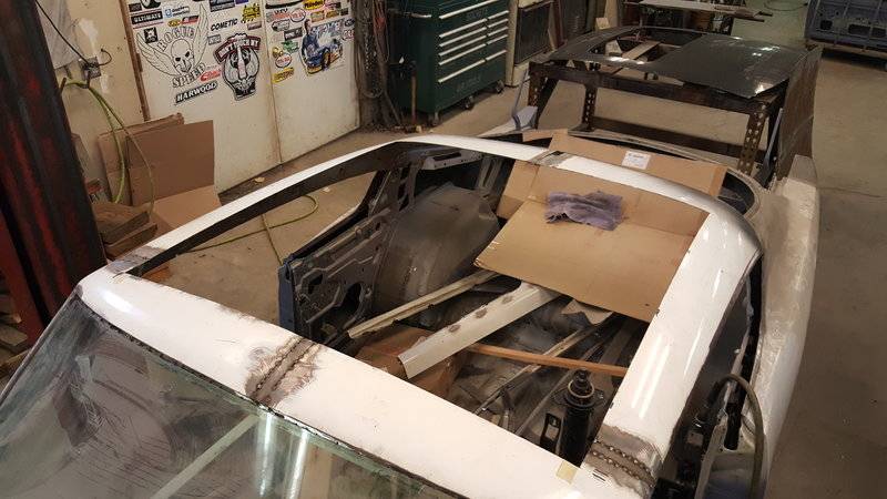

The only real huge mismatch is the rear corners. In the pic the rear is sitting higher because of the inner structure for the window mechanism to mount to. After I cut the Cuda roof to make clearance, it will sit a lot better on the roof. If everything goes well, I should only have to curve the rear corners a little bit to get to the same form. I might even cut the rear corners diagonally to make fit better. All in all, it's pretty close. :)

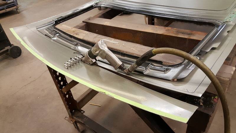

Marked the roof about 1/2"-3/4" inboard of the perimeter of the new top. Took some masking tape and made some cuts with the cutoff wheel.
Put the new top on and drew a line on the underside of the new top to get the hole size after I squared the top up in the center of the roof.
Cut the excess off the new top about a 1/2" wider than my marking lines. I want it to overlap the old roof for extra strength.
Here I'm using my flanging tool to make a step in the original roof metal.

The new top fit really close to the Cudas roof curvature.

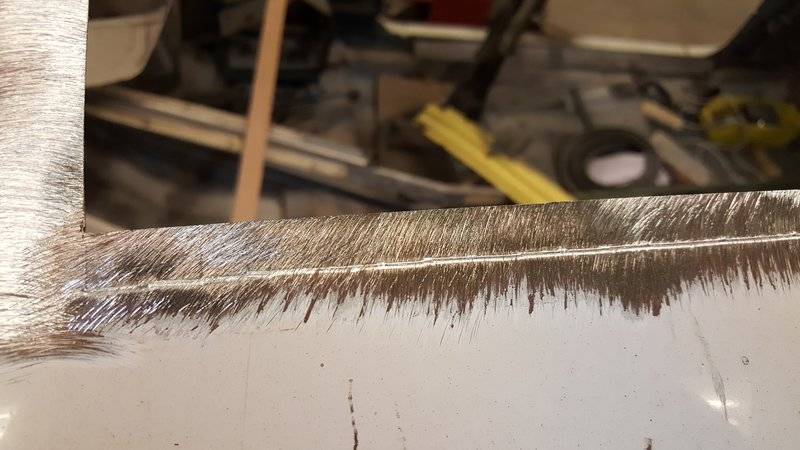

As you can see, it came out almost perfect with the original roof. Some minor tweeking and a lot of welding and grinding, no one will ever see any difference.

There's still a bunch of welding and grinding to do. At Least 2-3 hours worth. So far, about 3 hours total. (putting the sunroof in, not the chop.)
