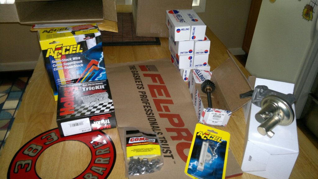

Put in the orders for the last of the parts I need to complete the engine, not a lot but some small stuff. Should have some boxes coming with my windage tray, valve spring retainers and keepers, new melling intake/exhaust valves, oil pump drive, and deep sump pickup. I discovered that my block has already had the oil pickup passage drilled out and tapped for the 1/2in hemi thread pickup. I'm going to have to plug or weld up the holes drilled in my 7qt pan from when it was used with an external oil pickup.
More boxes arrived today! Just waiting on one last box from 440source with my windage tray, pickup, and pilot bushing. Update on the finger, going in for another surgery this coming thursday, a lot of the flesh around the bone didn't survive and the doc needs to put me under so he can see what he has left to work with, wish me luck! Not lettin' it get me down, I still got a car to finish and now it owes me. :burnout:
What could be in these?
Surprise! Lots of stuff!

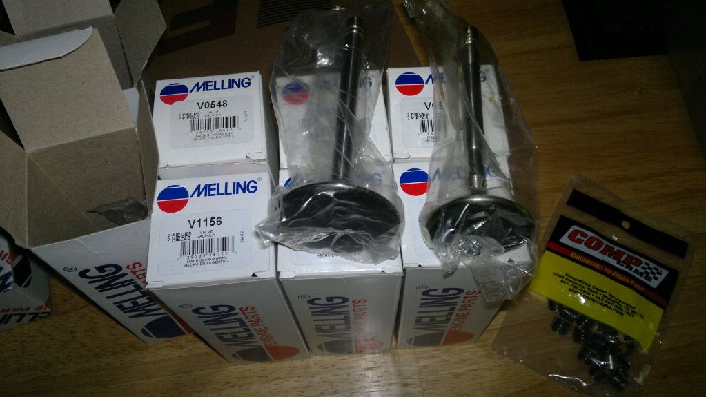

Melling intake valves and comp locks.

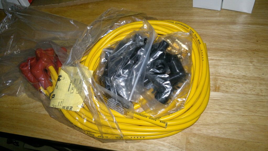

Accel 8mm wire set, cut to fit. Will fit well with EVERYTHING else in my ignition system also being Accel and yellow.
The air cleaner decal I ebay'd is surprisingly an actual mopar piece. Interesting.
The new to me holley 4160 and super coil, 140001 for a points ignition, got the correct .85ohm ballast with my other order. Carb will need a rebuild and I'm tossing around the idea of milling off the choke.

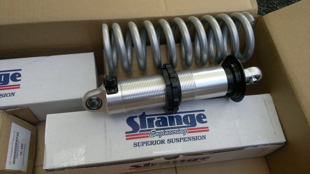

Strange single adjustable coilover shocks to go with badarts front end parts, 450lb/in QA1 springs. Total is going to be 10in collapsed and 13.84in extended, excited to test fit the wheels it should have a mean stance. When I'll be running it around on steelies with center caps for now because it's what I've got but in the future when I have the bucks I'd like to get some nice lightweight aluminum wheels. I'm a sucker for aluminum 5 spoke wheels, simple, light, and do their job, I know you usually see these on imports but if I find the right one I think I could make it fit nicely I've seen a few cars on here that pull it off.

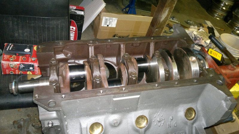

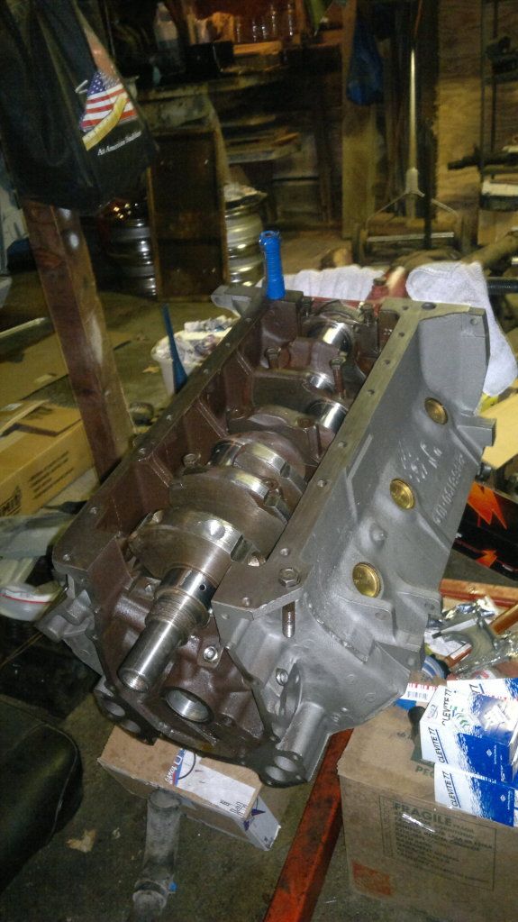

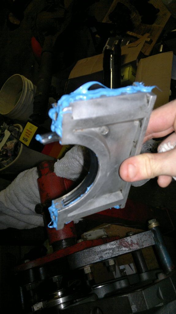

Progress with the engine today! Got the all the piston rings filed save for one that I'm waiting for. Crank is in, plastigaged the mains and set the rear main seal in. Was plenty liberal with the RTV on that cap. I will not be surprised if it leaks anyway lol. Should have the pistons plugged in by the end of the night. :happy1:

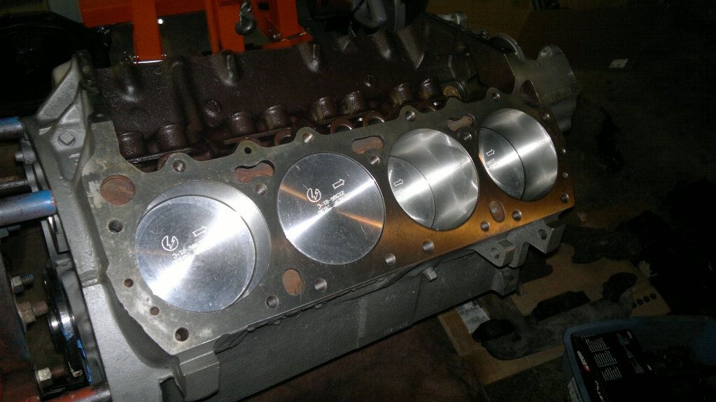

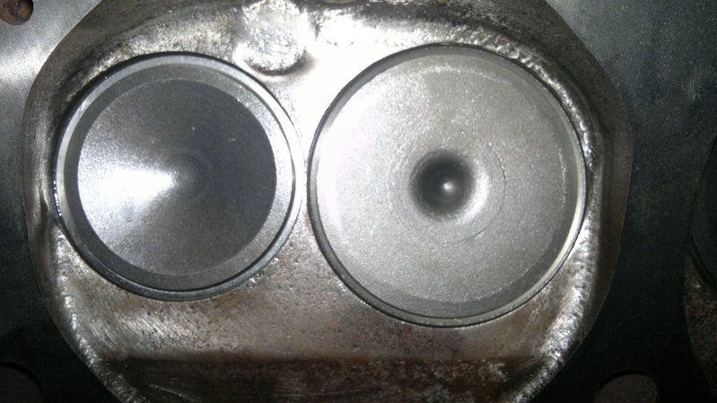

Pistons in! Got a nice surprise once they were installed, I knew the block had been decked but I didn't know how much. It's been zero decked, pistons sitting nice and flush at TDC, should be good for compression.
Yummy ,a zero deck motor!! Your gonna love it. Throttle response is sharp,idle always sounds soooooo crisp! Then you step on the throttle and get this amazing BARK!!!

Yeah I'm really excited to see how it will perform under the pedal! Though I would still like to bring compression up a bit higher, right now it'll be at 9.3:1 I'd like to get it up to 9.5 and was thinking I could just have the heads shaved a bit. Right now I have a pair of open chamber 906 heads, I'd prefer to keep them if only because they've already had port work done on them before I got a hold of them. Anybody have ideas how much I could reasonably shave off the heads?

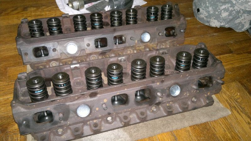

Just got these babies back from the shop, crank polished out to fix the spots I knicked and the heads are all done. :glasses7: Machinist said he hadn't seen engle racing parts come through his shop in a long time :burnout:

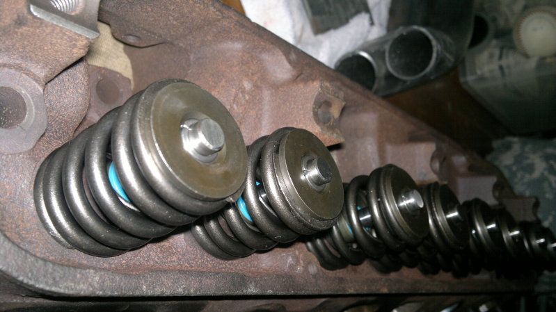

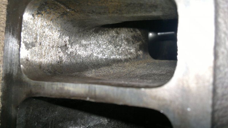

We were initially going to use a set of 440 source spring retainers but couldn't get the correct installed height and seat pressure out of them. I ended up pulling a set off of a pair of stock heads I had lying around and that got us withing 10lbs of recommended. I had hardened seats installed, a slightly larger exhaust valve, 3-angle, valve guides machined for new seals, a little bit of bowl work, and resurfaced. I'd say I did quite good for $500, he had originally quoted me roughly $460 for the work but it ended up being at $613 total. I had just mentioned it as a side comment asking what had brought the price up and the owner immediately offered to "split the difference" at $500, a bit more than a split I'd say and just another reason why this guy has my business forever.

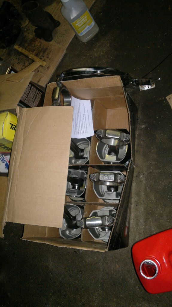

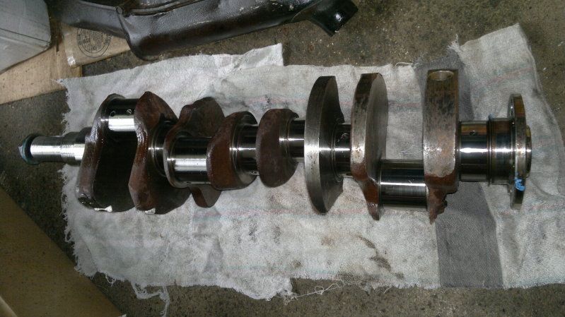

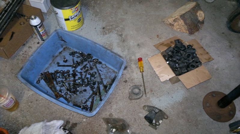

Moving right along, I got the nice clean, freshly polished crank back in. Pistons will get done tomorrow and I'm damn sure they will have rubber over the rod bolts this time. :happy1: Then I went of to clean up my rockers getting ready to put them on my fresh heads. That's my high tech parts washing system complete with my screwdriver to stir the muck stew. By parts washer I mean "great way to get mild chemical burns and sometimes it cleans stuff." :cheers:
I have the same parts cleaner works good in a pinch and it stores well lol.I use mineral spirits,cleans gunk with no "oh I need some water to get this cleaner off my hand".Motor is coming along nicly.
