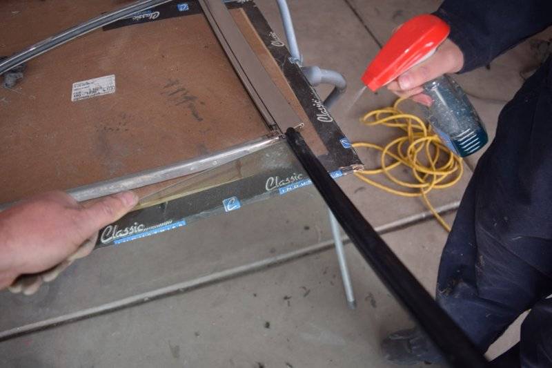

The new weatherstrip is on. It was a bit of a challenge but just use some dish soap and windex as lube.

Also will add when sliding glass into channel I sprayed silicone in it and with one person holding the frame the other can guide the glass in it easier not crushing the over priced felt strips. We also used channel locks with tape on the jaws to squeeze the rubber seal into the channel. I only have one good hand so this worked great and didn't hurt the seal. The work you are doing is excellent, keep it going!

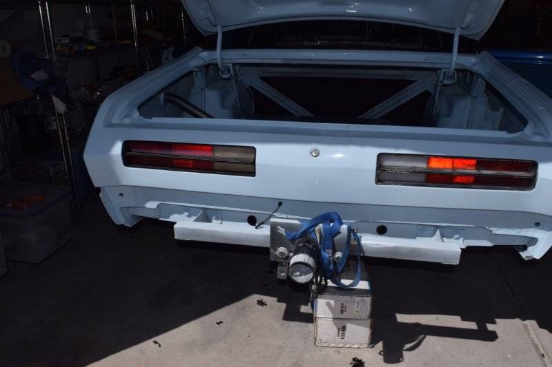

Then the downer. Started installing the RamMan booster kit. Well... again a ton of missing photos but I had to modify and reposition the braces and then come to realize the lines in the master cylinder have different fitting sizes and the rod to the brake is too long.... Guess I have to dig through the parts that came with it and figure out what needs to be done... Should have sent him the factory booster and bought a NOS cylinder and put in a new piston assembly and I would have been done now.. hate aftermarket... think I have mentioned that once or twice before...
Sometimes it is just the simple things that fascinate me. I was bead blasting the bench seat tracks and one of them fell apart. Once apart I pulled it all the way apart and the design was fascinating. I cleaned up the old dried out grease and blasted everything clean. Shooting it with black epoxy today. I will take photos of the assembly.
The Dart original booster is off to Booster Dewey (I used RamMan for the Coronet but that place has communication problems. Call Booster Dewey and he answered the phone on the 3rd ring! You never get to do that with the RamMan)....
NOS master cylinder coming from Brad's NOS Parts and a Raybestos rebuild kit is on its way (50 year old rubber is too old for a safety item).
I have a RamMan Booster/Mastercylinder/Proportioning Valve with brackets, fittings, etc that I will be selling for a smoking deal once I get it together and some photos. If someone gave me $400 I would take it ($570 from RamMan).

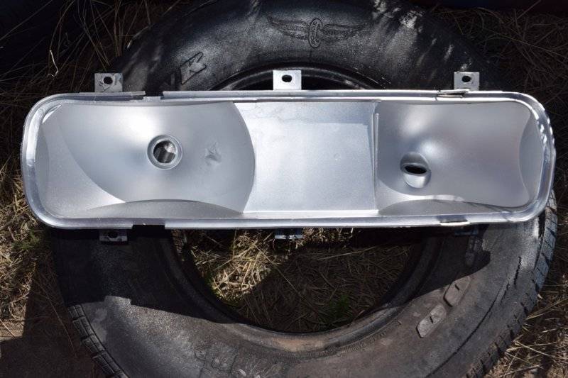

Fast forward to today.. The tail lights were in rough shape. I dremeled grooves in the broken tabs and cracks then taped the broken tabs on ready for JB Weld.
The dremeled grooves in the cracks
Laid in JB weld with a popsicle stick on EVERY tab to give it some strength..
Tape built dams for rebuilding missing plastic.
Here are the old somebody drilled for a hack light. Tape on the inside and filled with JB Weld.
Ready to put aside to dry..
The hole fill kept running so I put tape over this side to hold it in.. I have to sand it anyway so I will just sand the tape away when dry...
This is the LH tail light I restored yesterday. I know know it should be Argent but holding this up to the tail panel with the Twister stripes Black is the way to go. The RH side is cracked horrible. I JB Welded it but found a decent lens only on eBay for $35. I ordered it.

The JB Weld was hard this morning and Kaelyn was ready to go. Worked all day on a variety of projects....
The tape pulled right off! No sticking at all. Perfect...
I used a file to flatten the areas where the bolts and then some 320 paper by hand.
Started with 80 grit. Be very careful you don't dig the plastic too hard. I would start with 180 next time to reduce the amount of sanding to fix these scratches..
Then 180 grit to finish it off.
Mixed up so filler I had left over from the body work and filled it.
180 - 320 - 800 grit and it was all smooth. I then put it in the bead blast cabinet and blasted it all to a consistent sheen.
Kaelyn spread the reflectors with Krylon Chrome paint.
SEM satin black on the backside and the Left one is done. The right I am waiting for the new lens before putting it in for good. It is just finger tight right now.

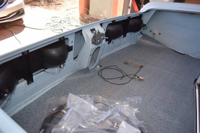

Installed the trunk light
Body Plug installed
And installed the carpet. The sill plates are in bad shape and the polishing can only do so much.... looks like new one if they are available... Kick panels are cleaned and dyed. Need to reassemble the seat tracks and get the front seats back together.
