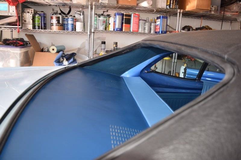

Reworked the headliner in this area and made it much tighter. Looks a lot better. You can play a tune on it like a drum it is so tight.
Same on this side.

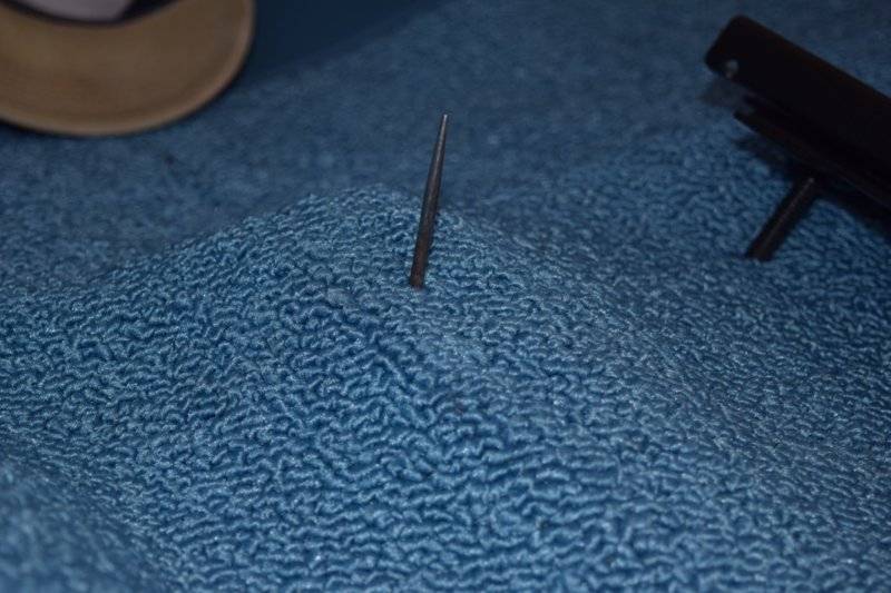

I mark the seat hole buy pushing an o-ring pick from the bottom.
Carpet knife around the pick and your done.

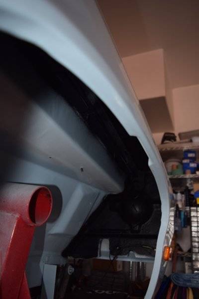

Sprayed undercoating in the front wheel wells. Only put it where the wheel directly throws stones...
We then got the seal kit out and got the inner fender shield ready to install by installing the seals. Also installed the flap on the starter shield that was in the kit.

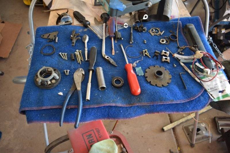

Wasn't sure what to work on today so since we started to pull the steering column apart last night we decided if we could get it apart and cleaned up ready to paint by noon we could get the dash out and wiring finished in the afternoon
.... Sort of worked out.... Once we got the column apart and realized I had all the parts we needed to restore it (I took a guess a few months ago) I got energized and fired up the paint.....

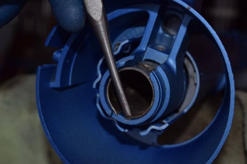

The snap rings go in front and behind the bearing in the first casting.. We will take better photos of reassembly... Disassembly sometimes get a bit disorganized as I try to figure out how things come apart...

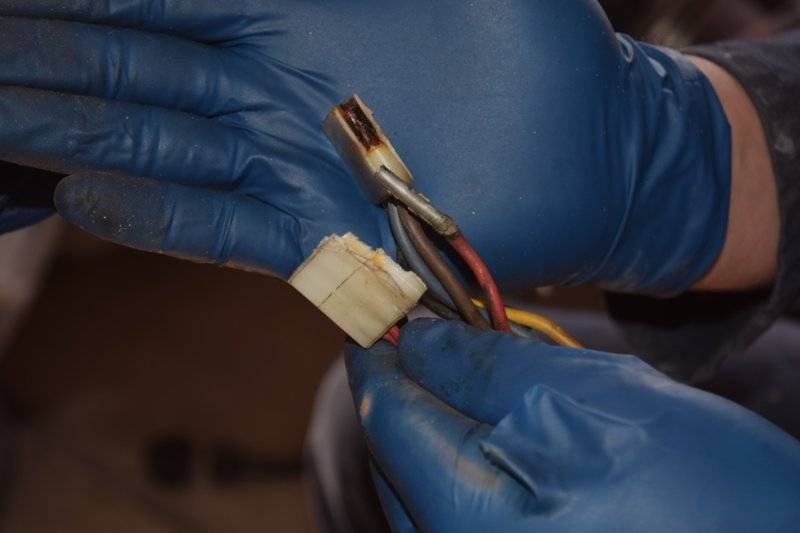

Here is why you replace all things electrical in 50 year old cars!

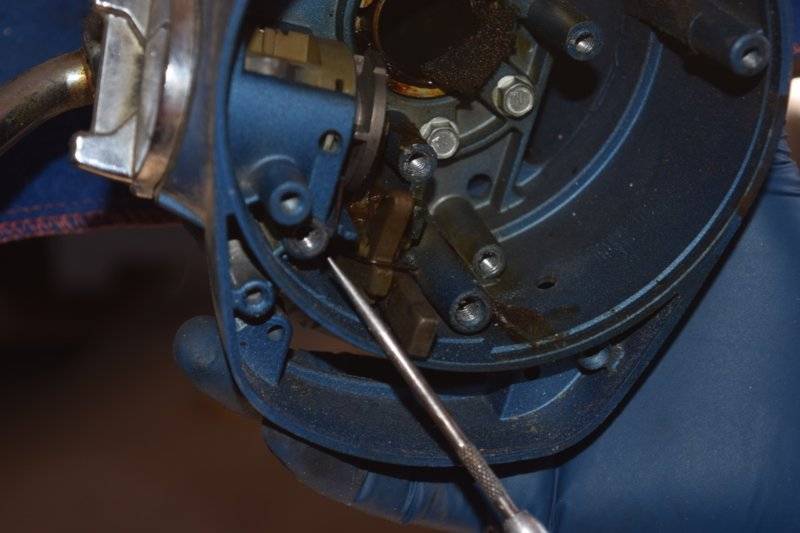

The lock cam is confusing so here are a lot of photos of it and the spring.. Note that it will pull out as one unit and you never have to take it apart. Just clean it and re-grease it.
With the key out press the pin in the hole and pull the lock out.
Another shot of how the wheel lock pins slide out as a unit.
Some close ups of the wheel lock spring and cams.
Now press the pin and pull the lock!

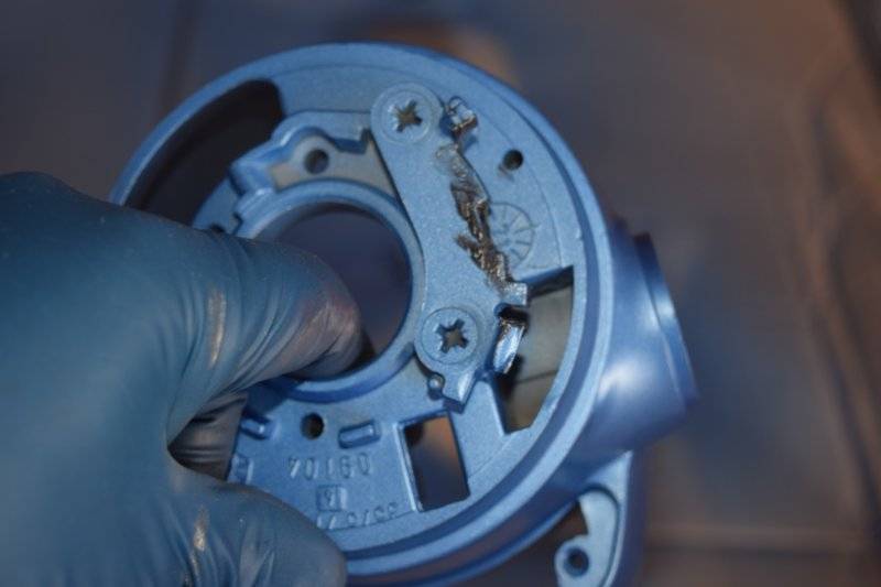

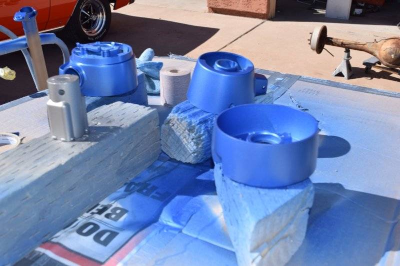

Kaelyn cleaned up all the parts with Acetone while I bead blasted and prepared for paint. The upper bearing just needed to be cleaned and repacked with grease. Just like new and likely 100% better quality then any replacement.
Shot everything with reduced SPI Epoxy primers. Only wanted enough for the grip on the metal, nothing more.

The firewall plates got a coat of black then a mix of SPI Universal Clear with a 33% flat and a bit of reducer to help make the column a bit flatter than the dash. I think it hit it perfect. If we wanted to make the dash more original then this is the mix.

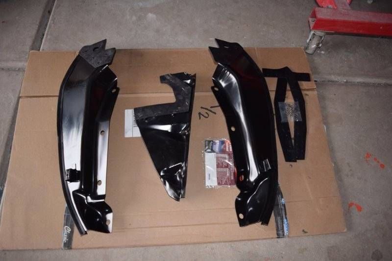

It was too late to work on the dash so we installed the inner fender shields. Again aftermarket (AMD) and they needed a bit of grinding on the lower bolts holes and the drivers needed a bit off the edge so it was not pushing the fender outwards... Other than that they look great. Also installed the headlight gaskets in the inner fender. Kaelyn did them all on her own. She is getting very good with tools. She did a lot of work today on her own! Proud of her!

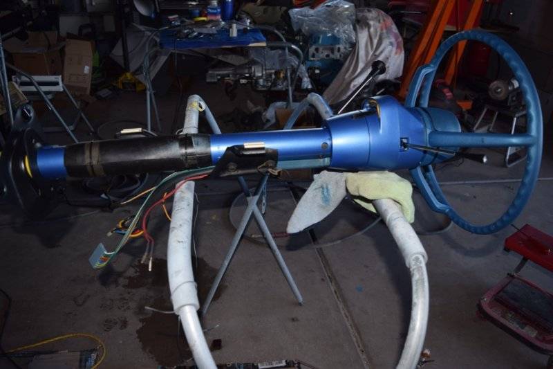

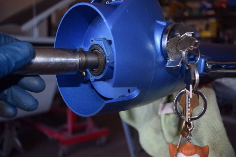

Column time!
The lower bushing is only to keep the shift tube from being loose. Various places claim this needed for steering.. Not true. So I masked off where the bushing use to be..... seemed like a good idea but it failed.... more to follow....
You can buy a split bushing so you can install it without disassembling the entire column so that started an idea. Why not just split the original and shim it out with electrical tape. If I need to replace it with a split type in the future it is doable but this saved me $30 and is likely better.
There we go... so I think.....
The shift casting goes on next..
Guess what...the original did not have the clip to hold the bushing so it worked it way up into the tube so my tape is in the WRONG place... damn...
There is a depression in the tube so tighten the allen just a bit then slide the casting around until it loosens up and the allen falls in the depression. Then snug it down.
Bend the edges of the tube to keep it from turning if the allen comes loose.
Lube up the cam for the shifter lever to ride on. This is the casting for the key cylinder.
Install the 4 bolts an torque them down.

Cleaned and installed the indicator light housing from the rear.
Son of a $itch.... Don't for get the damn spring washer.... Took it back apart and greased and installed the spring washer...
Bead blasted the wheel/horn pad/wire cover and scrubbed with Acetone. Took it outside and sprayed with Herb's dye. Have I mentioned this stuff is amazing?

Now install the 2/3 clip for behind the upper bearing
slide on the cover to keep the roll pin from every coming out.
The final casting goes on next.
The indicator was dipped in my Coronet Orange earlier in the day so it was installed and aligned.
Now the upper bearing goes in. the original was in perfect condition after cleaning it with Acetone and repacking.
After tapping it in install the snap ring and use to seat it the rest of the way. I use a socket to drive it home.
When the bearing is all the way in the snap ring ends will come together as it falls in the groove.

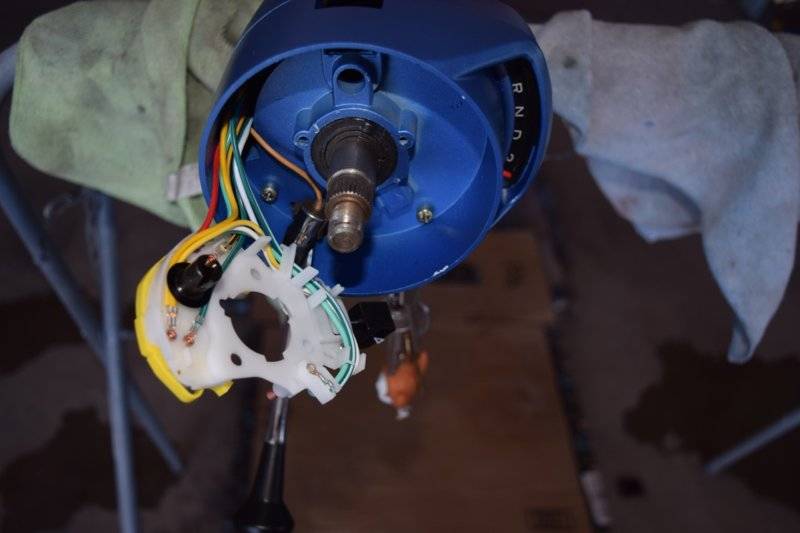

Work the new turn signal harness down the column.
Install the plate and screws.

Wheel goes on next. Thought I was cool marking it but this wheel and shaft are indexed with a flat spot so it only goes on one way...

Someone at a desk thought a big heat shrink tube around the ignition switch wires was a good idea. Not in practice. Cut it back so it would fit in the harness cover.
