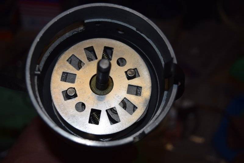

Distributor.... Factory original that was pulled apart (not the shaft) and cleaned up. There is zero side to side play in the shaft so I am reusing it...
All the way in the bottom. This is a '73 car so we so some math. The factory ran them around 34 degrees all in on the advance and around 0 at idle so that is 34 degrees of mechanical advance. That says these likely around 17/18 degree weights (divide by 2 since the dizzy spins half as fast as the crank).

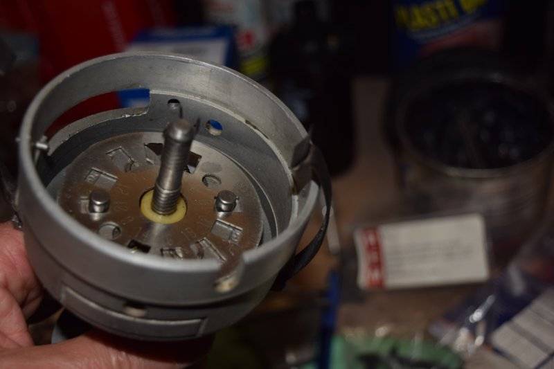

I used the softest springs from the FBO kit I bought for the Coronet..
Now the FBO plate that locks the weights to a fixed amount advance (old way was to weld blobs and file them off, this worth every penny it costs). I put it on the "10" mark so that means it will lock it down to 20 degrees of total advance at the crank. So if I want it to run at 34 degrees at high rpm my initial timing will be around 14 degrees. That worked great for the Coronet we will see what it does for this engine.

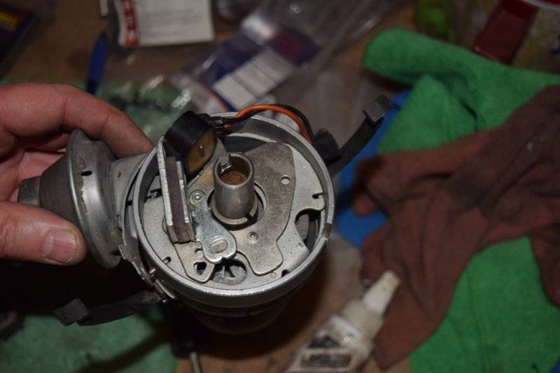

Next the pickup plate and getting the advance pin in the hole while standing on one foot...

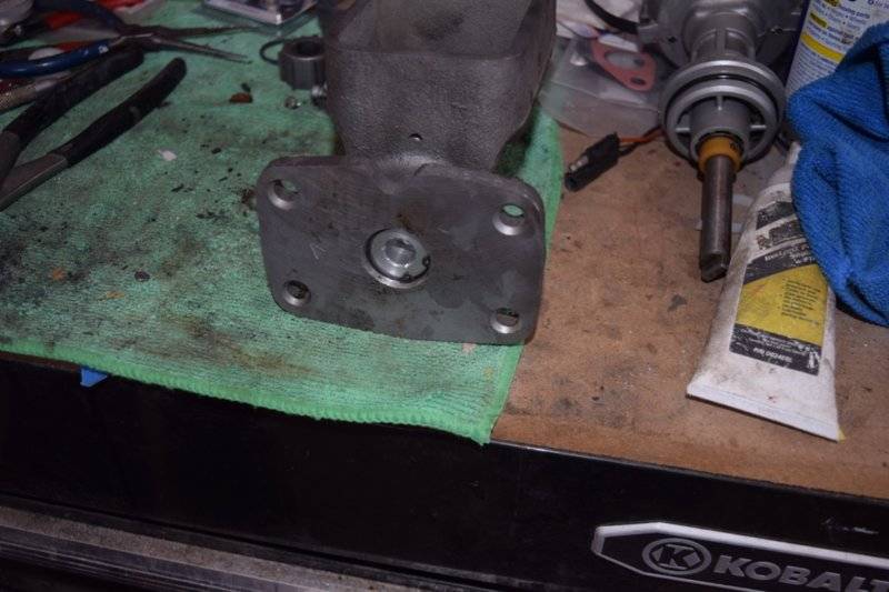

Now the NOS master cylinder. I disassembled it the other night and used my brake cylinder hone to clean up the bore.
First thing is the installed the flare bushing. Here is how I get them off. This an old tool for removing the emission plugs to get to idle screws on carbs. Remember those? Screw in and use the slide hammer to pull it out. Easy.
In this cylinder only the front tank has a check valve behind the flair bushing. The Coronet had one behind both. The kit was correct and only gave me one so make sure you note it when your pull it apart..
Just set them down in the housing.
I use the lines to thread in and push the flare bushing into the housing. You can feel them go in and bottom out..
Now lub up the bore and new pistons
Front one goes in first. Be careful to not cut them so go easy and twist slightly.
Now the rear tank piston.
It is tricky to get it in as you have to compress the spring and get the snap ring in. Kaelyn put in the snap ring while I pressed.
Now the set screw to hold it together.

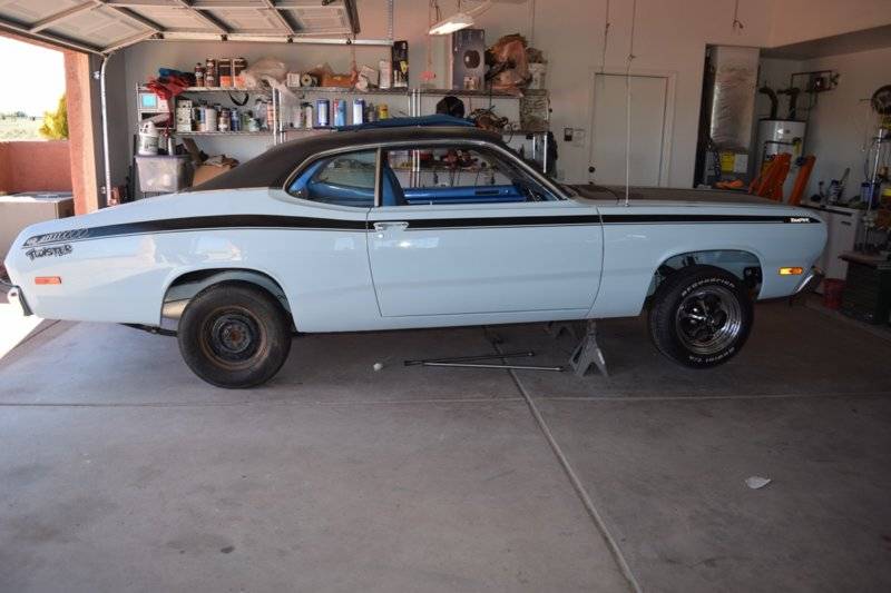

Here is the photo shoot!

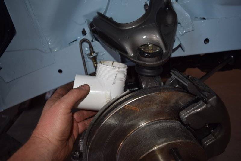

One little trick... A 2" PVC street 90 or this threaded 90 makes a great dual purpose tool...
Cut 4 slots with a hacksaw like this:
Now it can slip over the upper ball joint rubber seal and when you smack the back with hammer it will expand as the seal seats down on the ball joint. Nice boot installer tool..
Now flip it over and it fits perfectly to drive the wheel bearing seals on the disk brakes!

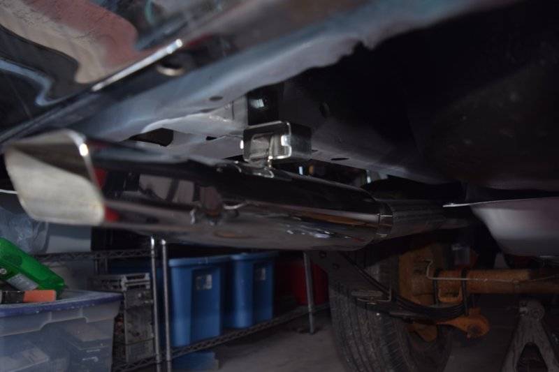

Opened up the Accurate Exhaust box and started fitting it. Fits like a glove except for the tail pipe area and the chrome extensions. I may have the hangers backwards, I need to call them in the morning.
