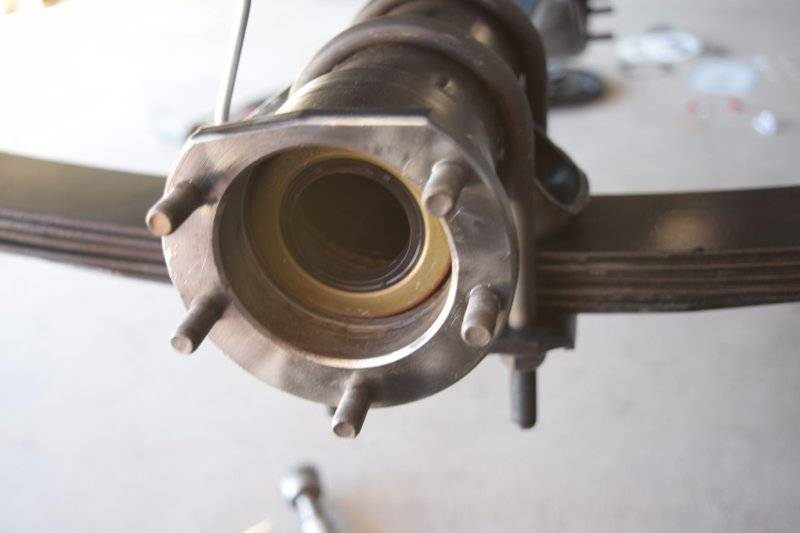

Rear axel is done. Classic sent me a HD shock so I need to order another, I have one of each so we will see what lady luck brings us...
1968 B-Body brake hose fits perfectly...

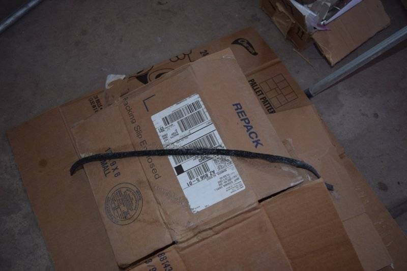

Those fat garden hose washers work a treat for the rubber spacer between the cable and the backing plate!
A Body parking brake cables fit perfectly with the B-Body axel
