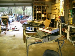

Well.....

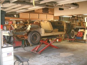

Here we are at Waggin's place in Florida!
This was her 1st real road trip since I bought her.
Absolutly no problems,
Gonna have to get the Cruise Control in before the next trip though as she wants to cruise at 80-85 MPH!

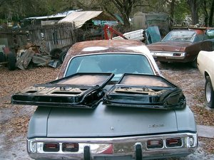

Now, since we got here she has lost her Munched up, Bad Hinges, and Seal-less Doors....

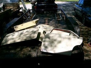

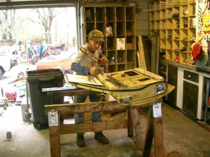

And Waggin working on the Replacement Doors from a '74 Valiant Sedan he parted out.
I also got a Inside Hood Release, Trunk Light Setup, good used Side Markers, and Bumper-ettes offa the parts car.
Oh... he IS keeping the '74 Valient drivable Chassis around as a Yard Dawg....

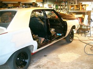

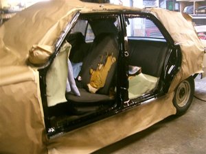

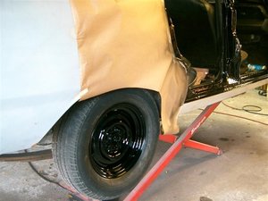

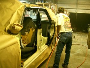

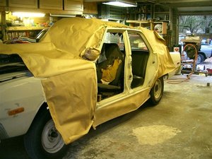

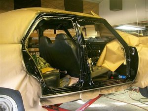

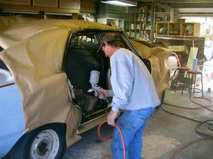

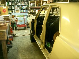

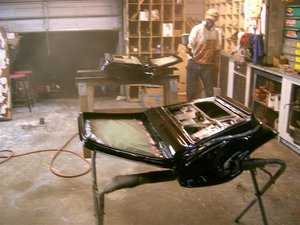

Tuesday.....
Got the Passenger side stuff painted.
Waggin at work.
Done

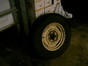

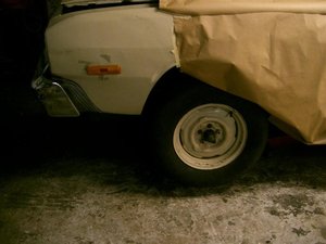

Rims... Before

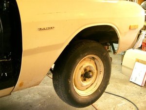

Rims.... After

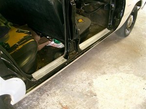

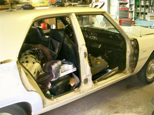

Passenger side Door Jambs and Rims... Done!

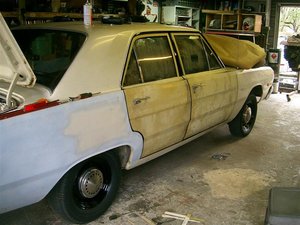

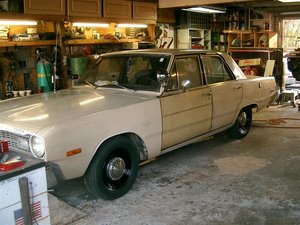

Passenger Doors.... Done
That was all on my car today.
Tommorow is Drivers Side day.
Oh..... By the way, I decided I am painting her Black.
Later,
Bruce B.

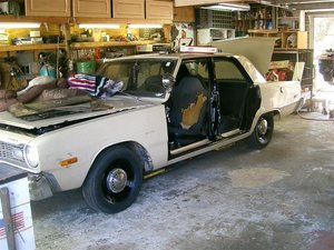

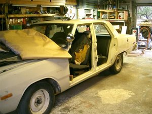

Ok,
Here is March 26, 2010 work. Finished up the Painting for now.
Out with the old.......
That's it for this trip to Dr. Waggin's!
All for today!
Later,
Bruce B.

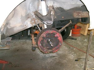

Well.... Front Bearings sounded bad to Waggin.......
Took them apart and they were in need of repacking. Also the Passenger side Outer Race was spun. Waggin peened it to fix as good as could be, I repacked all the Bearings.
I need a new Spindle and Hub....UGH! I would rather just convert to Disc Brakes whille swapping the Spindle.... Anybody got a set of Spindles, Dust Shields, Caliper Mounts, and Proportioning Valve for sale? PM me if you do. I already have a set of Rotors and Calipers out in the barn.
This marks the end of this bit of work on my '74 Dart PD.
