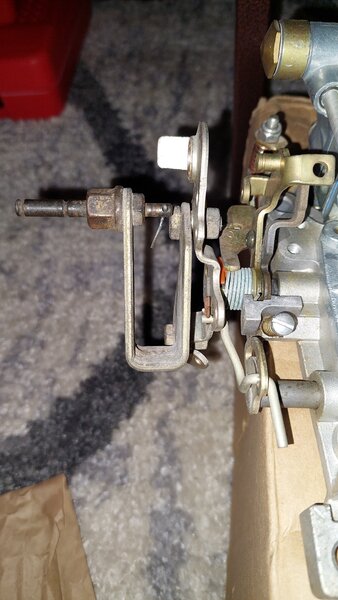

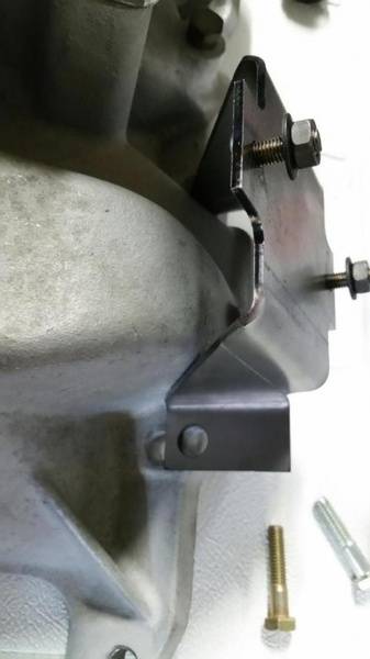

I got a few parts in from Mancini for the above swap. Here's the list.
HFAX42 68-70 return spring bracket
HF0060 Small block 4 barrel throttle cable bracket
HF407 340-6 coil mounting bracket

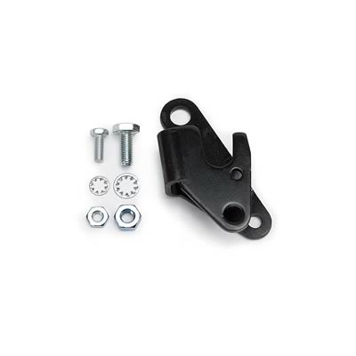

1843 Edelbrock throttle lever adapter
for you automatic transmission fans, here's a handy adapter to extend the kick down linkage as needed.
Edelbrock 8004. (Last photo)
The return spring bracket sets a bit crooked but will work fine with a little tweak.
The throttle cable bracket looks like it will work perfect.
The throttle lever adapter fit good and should work fine

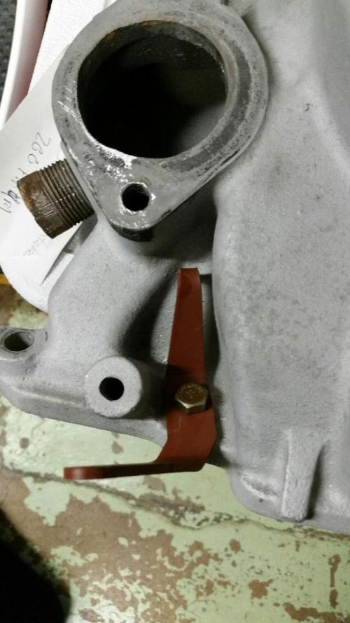

The Coil mounting bracket will need some grinding to fit simply because the intake runners on the LD4B are wider than the factory 340-6 runners.. If you spread the ears out to fit over the runners the bolt holes won't line up.

Mancini 340-6 coil bracket

Edelbrock 1843 Mopar throttle adapter fo most Edelbrock/Carter carbs. There are quite a few different ones. check to make sure there is one for your carb.

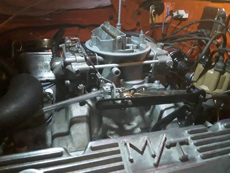

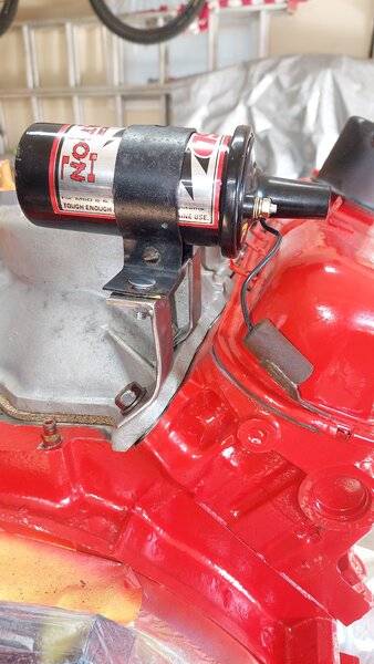

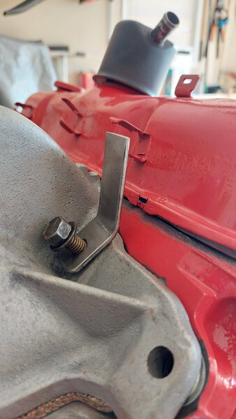

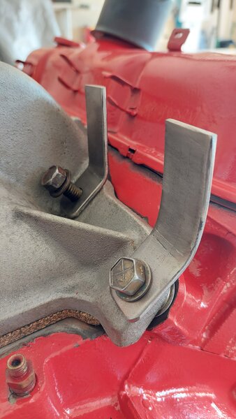

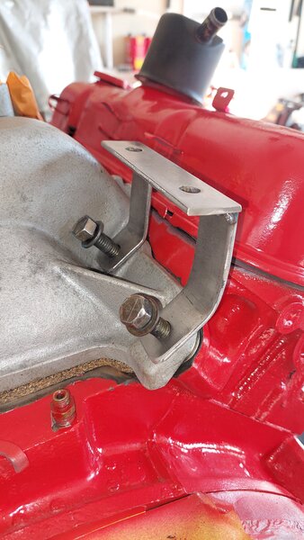

I had some flat stock kicking around so decided to build a bracket for the coil on my LD4B. I'm happy with the result.
340 brackets arrived from Mancini... getting them painted up right now.

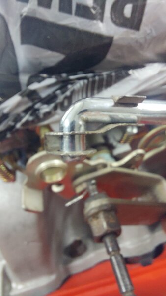

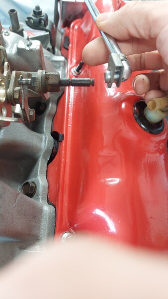

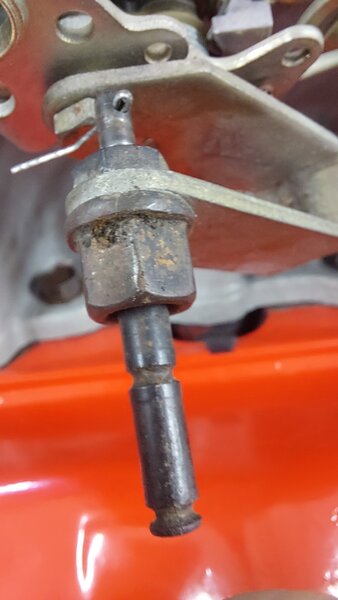

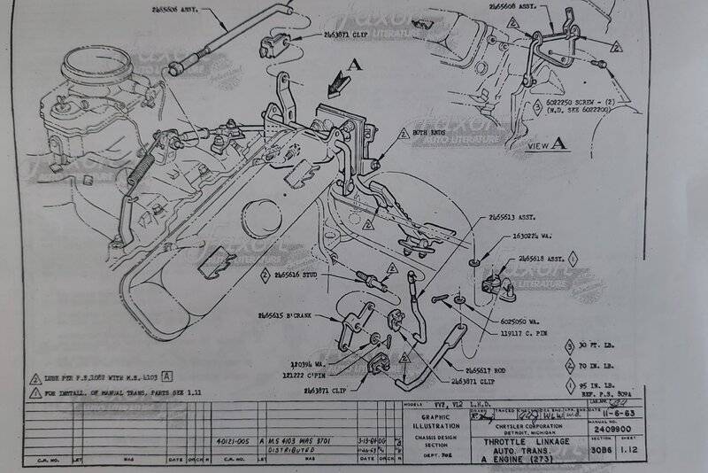

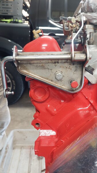

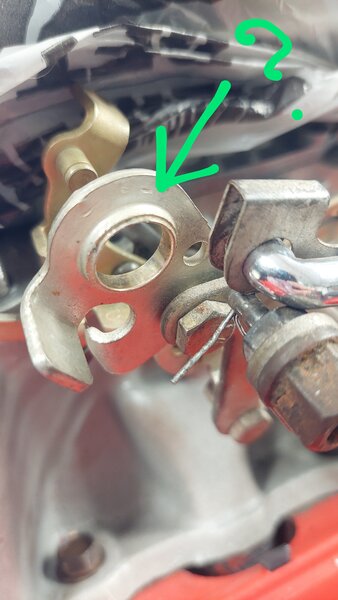

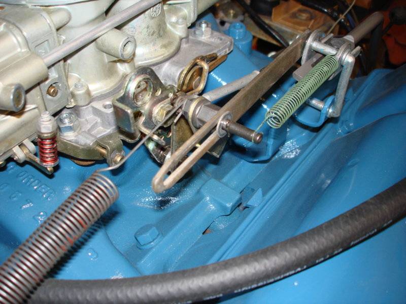

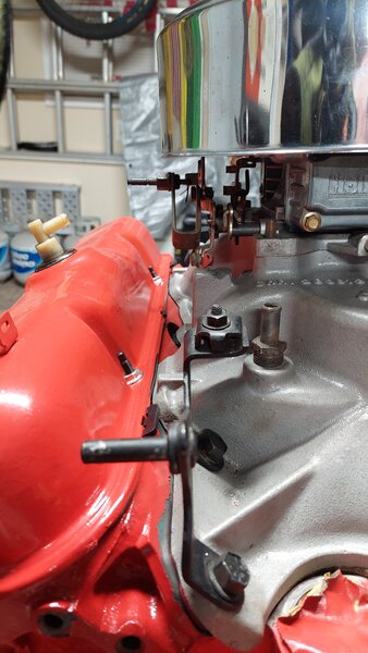

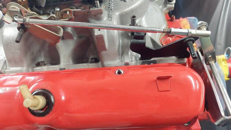

Puzzling on the kickdown linkage if there's some insight. Using the stock plate and linkage but not sure on the connection onto the carb. (?)
This is a 1971 318 with LD4B and Holley 4160
Thanks ahead of time for the feedback.

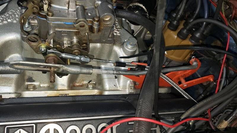

Nope. Te large hole is a GM thing. THey used a bushing for their throttle rod. Your kickdown is all wrong. It should look something like this. I can't guarantee these photos are correct. The pivot in the back goes on the post on the throttle bracket. THat transfers the horizontal movement to vertical that goes down behind the cylinder head.
This is what I was working from
