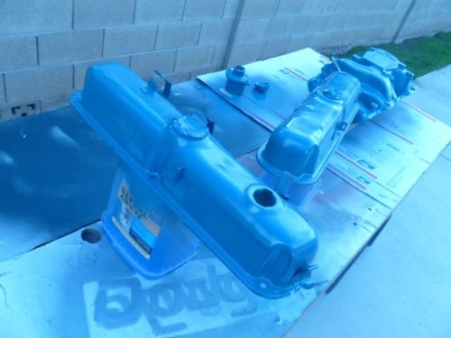

Nice photos! I hope the end of the throttle spring isn't in the cotter key hole on the carb side.
4spdragtop
CONGRATS NORTH AMERICA!
Aug 28, 2009
35,639
17,548
Wasting time here
Make sure to use composite Intake gaskets(dissimilar metals) alum vs iron. I used Felpro.
The 6pk bracket iI used is a pain in the crack as one of the nuts is a bugger to get to when moving/removing the coil.

Thanks DR for the stellar comment :D. Trying to get this done w/o too much aggravation. There's always more to a project once you get started....
NO tickets planned, but you never know LOL
Here's what tool you need to torque those hard to get at spots.
That would have been real handy today Mike!! Too bad you're not closer....
The old offset wrench we had really helped in a few spots. I doubt you'll have any tool problems when you mount yours :)

Last tip: Paint the manifold bolts, "After" you install them.
We used masking tape inside the socket & have done it before with great success. It works fine, but I can see your point too. Thanks Johnny for your help & suggestions :thumbup:
