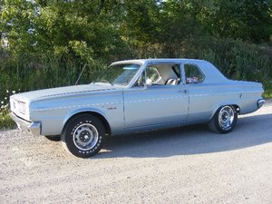

I need to post a completed photo. Dang, still got the timing light hooked up ! LOL

Now that looks good! Glad to hear you also fixed the oil pressure problem, probably just a bad filter. Just an FYI, 51515, 51068, 51085 all fit Mopars and are all 3 different lengths.
That engine sure looks sweet! Great job Mike. Gave me some hope to do mine engine too. And not to go on easy way and put some 318 on it...:cheers:
How does it run ?? how many miles ya got on it now ?

Great job Mike!I can,t wait to see it with the rally,s on it.It sure changes the look of the car,I think it adds a little muscle look.8)
