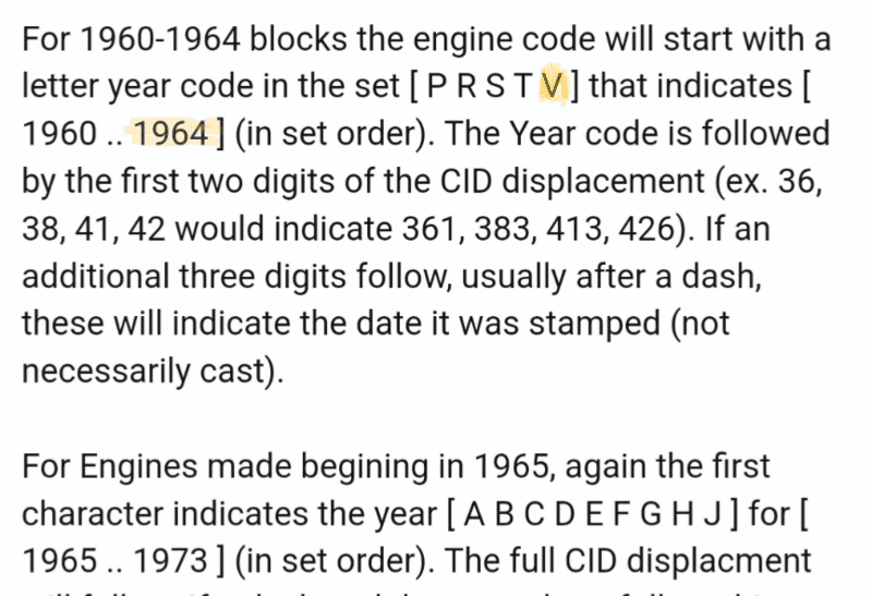

64-66 273 casting number. The -1 is the first revision so probably a 64.
It's a '64 block with V273 code stamped into it. It was just a weak stamp on the 2. Those early timing covers had the extra bolt hole to match the early blocks. It was decided that the extra bolt wasn't needed, so, it was deleted on the newer castings. The block casting numbers changed in '67 where they used both the casting number 2806030 and 273-? on the side of the block above the starter.

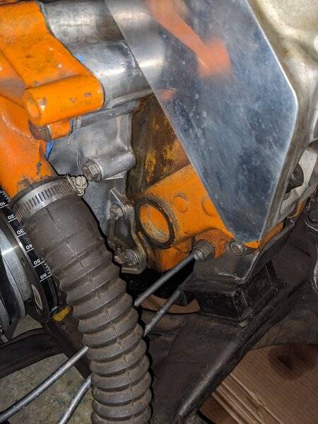

Well, I think I've got a few answers, but it also brings up a few other questions...
First, I think that's a poly 318 block wearing 273 heads. I'm not familiar with poly casting numbers, but I do know that the "A" engine (318 polysphere) used an extra bolt on the left side of the timing cover that is not present on any of the LA engines (273, 318, 340 or 360), all other bolts remained the same.

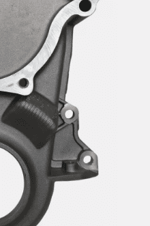

LA:
It looks to me like the timing cover rotted out and was replaced with a more readily available LA timing cover; and instead of just plugging the extra bolt hole with an allen screw, they notched the LA cover and ran a machine screw into the hole. Just a guess.

First off what's this deal ? I've never seen this in all my years of moparing ? Screw holding the timing cover in place !
I don't see 273 cast in the side of the block and is this actually a 64 273 ?Thanks for any and all insite !

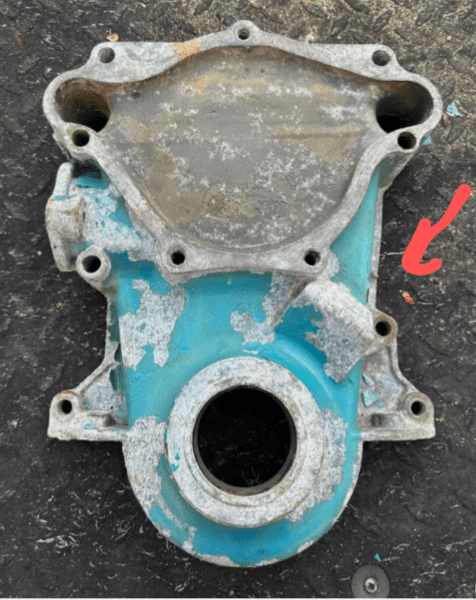

Small blocks had the extra hole and boss on the timing cover through 1967. I just checked my timing covers. When they updated the timing cover castings to the cast in passenger side timing marks in 68/69, the extra boss and hole went away on the timing cover. Not sure if the blocks had the extra hole, the blocks are harder to dig out than the timing covers.

Interesting. I figured the extra tapped hole in the block was gone by 68, but maybe 66 or 67.
On my '66's, all have the extra hole in the timing covers, but, no corresponding hole in the block, so, the hole in the timing cover is empty.
