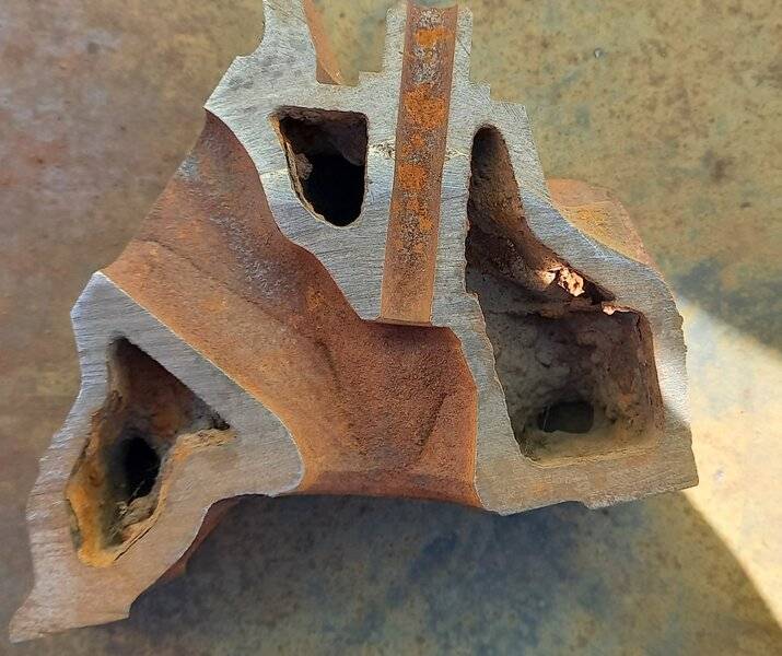

How thin is too thin?
I guess an 1/8 of an inch of iron is desirable in a 1000 degree exhaust port.
But if you want a free-flowing port then its gonna bee possibly 'half' that where the bump is loacated?
Do you feel lucky when using a heavily ported iron head.
Or is is best to leave the bumps in place and suffer a small flow loss?
I assume the small block head has a much more superior port compared to a 906 etc?
I have fitted 1.88 exhaust valves in iron heads as per David Vizard and others info.
I would have thought a 1.70 exhaust valve would be beneficial but most say 1.65 is plenty?
When taking max HP affects(this is not, that, of cores!) you are better to go to a 1.50 exhaust valve, to make room for a much bigger intake valve.
Intake air pressure, even in a boosted situation is Way Way, harder to get on top of the piston, then the 1000+ degree and all most, mach-1 air speed being forced out the exhaust. I know i know you say, so make it bigger, to get it out. It just don't work that way. The velocity and the over lap time is what help start the intake moving sooner. You can hurt your intake flow by messing with the exhaust side.
And that is one of the reason why i say Leave the floor alone! and only clean the exhaust port.
Just one mans opinion.
