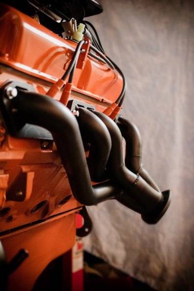

Maybe I could be converted after seeing the TTI shorties - I"m old school was unaware of these even though they may have been around for decades, sorry.
I thought all E body headers dragged on the ground.
Question please - Can/do these headers seal well against the head?

Those are a set of HiPo 340 manifolds, and as mentioned, will bolt right up with no issue. In regards to manifolds vs headers, it depends on what your plans are with the car. If a bolt on, painless,dependable, exhaust with decent performance is what you are after, go with the manifolds.
Accurate exhaust has a complete exhaust system for your car, from the manifolds back. TTi should as well.

In my opinion, if you have a 340 with a slightly hotter than stock cam, you will not be happy with non 68-70 manifolds. The 68-70 ones flow a lot better than others. In my opinion there is little sense in putting lower flowing manifolds on a modified (even if only slightly modified) 340; which is a performance engine.
I finally purchased a numbers matching 1972 Dodge Demon 340 4 speed assembled on 10/25/1971 with a rebuilt 340 engine to 69/70 Dodge Dart specs. The only thing I plan
to add is a set of TTI Headers. Since the 340 is basically stock with six pack cam 280 D 474 lift. Should I follow TTI s advice and run the 1 5/8 primary to 1 3/4 secondary
headers or can I install the 1 7/8 inch headers being that the Demon is a standard.
