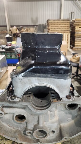

Time to bring this one back from the dead. Gonna drop a bunch of photos and explain them afterwards. Gotta run. J.Rob
I figure this engine won't appeal to a truck buyer and I had a lightly used Kevko 340 center sump pan and this is FABO.....grabbed an old 360 truck pan and we're on our way. J.Rob
