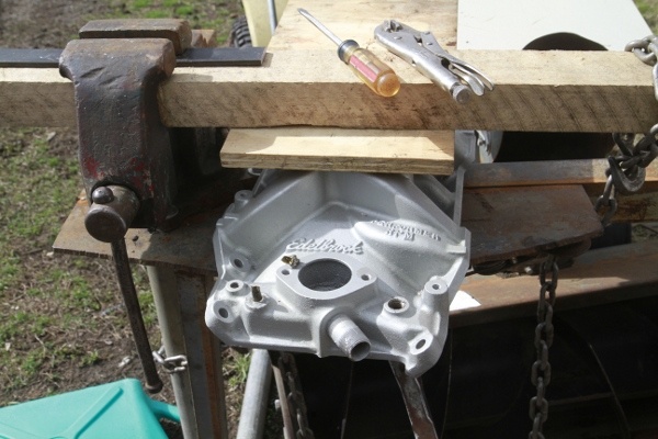

This one had a 3/8 over on the right for heater, a 1/4" for sender, and a second 1/4" I've no idea WTF is wrong with Edelbrock. Just like the OEM, impossible to neatly use a mechanical gauge. Not only that, the heater fitting is on the WRONG SIDE
Clamped on the "welding table"

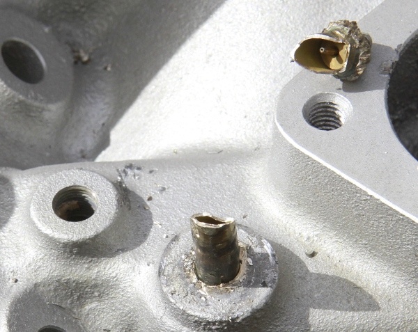

No idea what these morons thought they were doing. Looks like they "press fit" a mechanical sender probe through the middle of a bushing. I ended up chisling the inner tube off flush with a small sharp chisel, then drove "the remains" down inside.

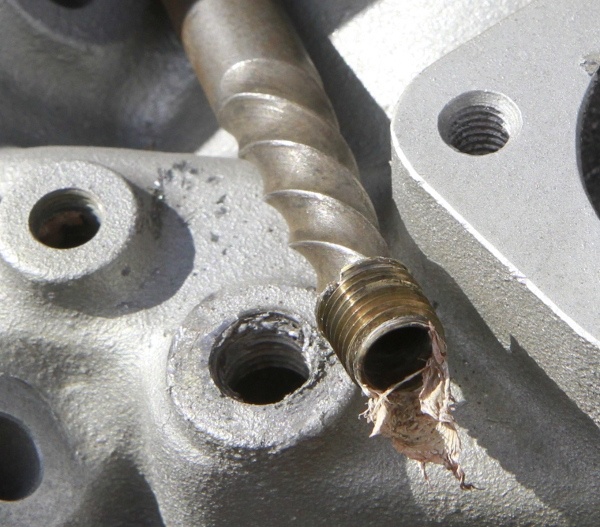

Chisled it off, managed to get it out with an "easy out" This is 1/4" pipe

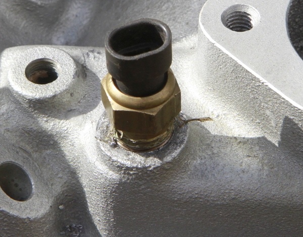

Drilled larger, and tapped for 3/8 for the EFI sender (Holley HP injection)
