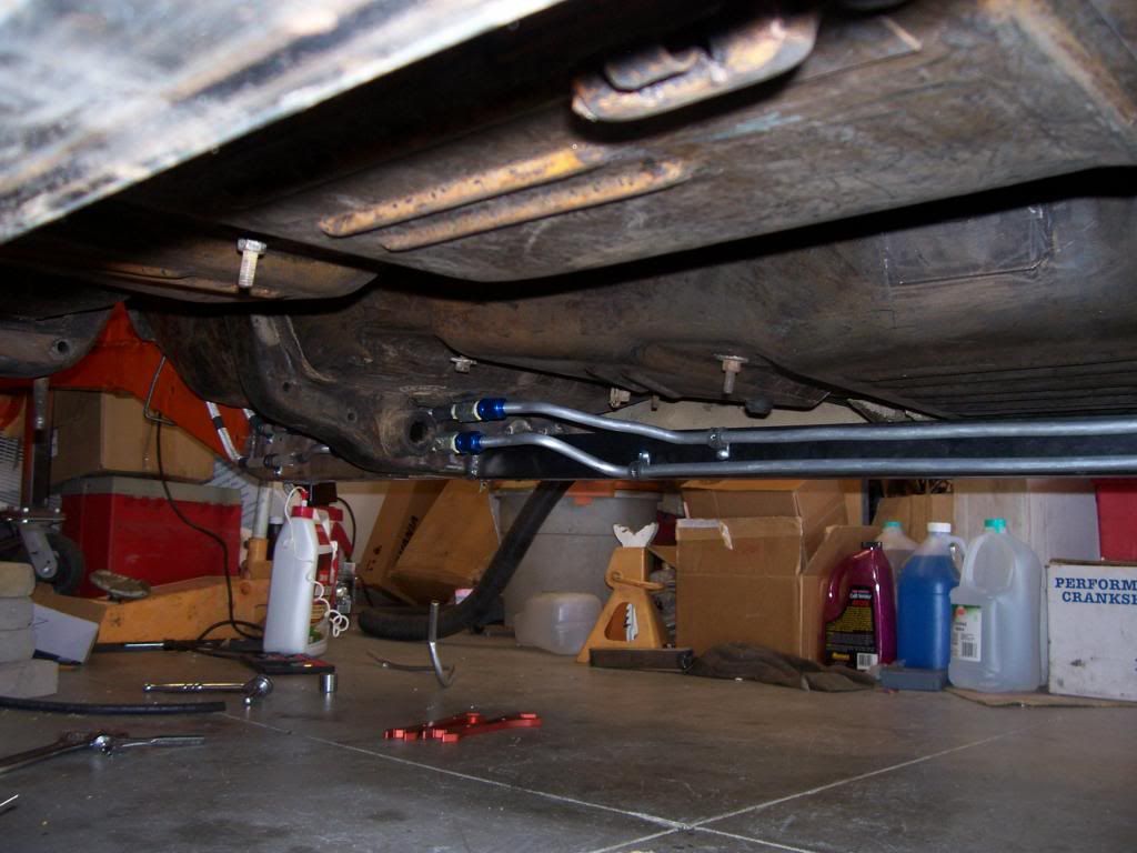

Geez Rob looks amazing !!!!! Nice to have a solid car to start with,Do you prefer the alum lines over braided??? Frame connectors next???? Nice clean job--Steve
Thanks Steve. If I did this car again, I'd buy ptfe/teflon braided line. The aluminum is sometimes a PIA to deal with. Buy the time you buy all the ends, the savings is not that great. PTFE hose is more forgiving regarding routing being flexible.
Frame connectors 2x2x.083 Fabbed up the rear frame sections. I didn't fishplate the torsion bar attachment point. If I need to later I will... got lazy and tried it this way which has worked well for others.
So the ptfe would be good to go e-85 ??? How are the fittings to deal with???? Steve
I ran my 1/2" lines just like that an they turned out great. I felt that the hard line just looked top notch over the braided stuff. MHO
The PTFE hose ends are a pain, but once assembled, they are good to go.
Yes, the aluminum line looks good with the black background/contrast.
Words can not decribe how much of a PITA the braided lines are.
I went with the blue line for my car, looks good with the red/blue fittings an the overall them i want the car later when i can paint the thing
