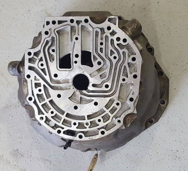

CMR, So this is very interesting to me. I have a 63 Dart wagon that I am thinking of doing a V6, I'd like an automatic. Does or is there a NAG trans for the 3.6? Forgive me for not digging through all the past emails.

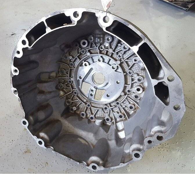

My wife’s 13’ JGC has a 3.6 and NAG1 trans.

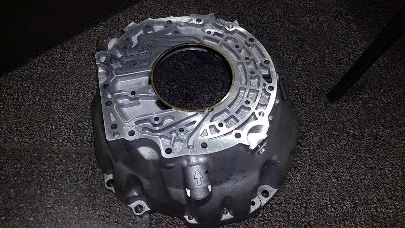

I used a 3.6 NAG1 bellhousing to mount my T5 manual.
3.6 came out around 2011-2012 & all used NAG1 before the 8HP 8speed came out around 2014-2015
3.6 Charger/Challenger 2011-2014
3.6 Jeep Wrangler through 2017
maybe a few years of Grand Cherokee 2011-?
