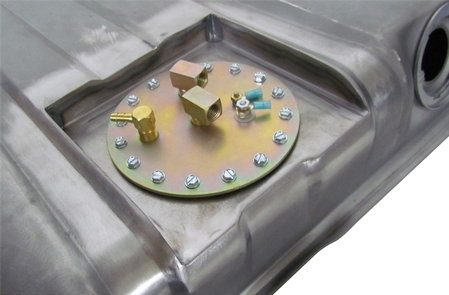

I got a Tanks Inc. kit for my '69 Dart. But it was not really bolt-in. I had to buy a new tank and have Tanks Inc. weld the recess into it for the top of the pump module to fit down into. Otherwise it sticks up about 1" above the top of the tank and the tank cannot be installed in the car. (Well, you could cut a hole in the trunk floor I guess, but who wants that?). Anyways, it works great. They have several pumps to choose from, I'm running a PA-Series full return system with the TBI pump which puts out 12psi. Using an Aeromotive 13351 bypass regulator set to about 6.5 psi at the carburetor.
The recess:

[/QUOTE interesting we use them all the time. Have never had an issue like that. If the sending unit sits on to of the tank like you posted they are all ready recessed.
On a '69 Dart the sending unit is on the front vertical wall of the tank. The Tanks Inc pump would never fit there, plus it won't work sideways!
