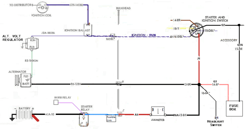

Do you have voltmeter? Clip the red lead to the battery positive and the black lead to a battery ground.
Rev the engine slowly while watching the voltmeter. If the amps to the battery go up with increasing voltage, then the problem is lack of regulation. Three possibilities then: 1. The alternator brush or green field wire is grounding. 2. Regulator has failed. 3. regulator is getting wrong information (reading low voltage or no voltage on its sense terminal).
Why the battery draws more charge with increasing voltage just discussed last night here
How the regulator works
Identifying Chrysler Alternators (1960-1976)
Post #7 has the links to MadElectrical
so, since were discussing amp meter bypasses, i seen one guy on youtube who simply ran a heavy gauge wire from the charge stud on the alternator straight to the battery (i guess this counts as one of the "big three" of general automotive electrical upgrades)
he left the amp meter in place and wired up as usual, claiming it is now no longer carrying all the current, since current takes the path of least resistance and simply travel through the larger wire straight to the battery, does this make sense?
