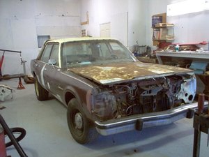

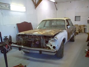

Any interest...?
sitting in her new home.
As you can see from the original shots posted up, the header has been removed. I took this off last fall and began work on it. There was a hole in the fiberglass under the driver's marker and a couple of cracks. I've been working on it steadily. Once it's ready for prime I'll have some pics of it.

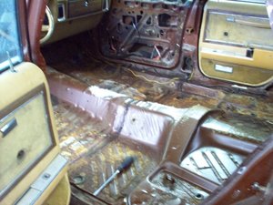

teardown so far. After a few days worth of work.
The interior is mostly gone. I've left the door panels in place for now for operating the windows easily. I want to keep the car rolling so as not to take up the bay since I'm trying to get back into building cars for a living. Got a few customers out there spreading the word for me as well as a few folks who want paint work done. For that reason the dash and column will also stay in until it's on the rotisserie.

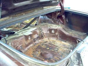

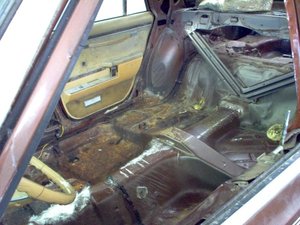

Rear torn down.

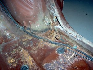

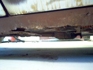

Got some rot, but that's not unexpected.
Left rocker panel under the rear door.
And above the rocker on the floor board, just inside.

Robert I have a bunch of clean F body steel around so let me know if you need any of the pieces that crossover. I believe rocker sections, trunk and floors can swap. Have to look it up to be certain.
Being from CNY myself I remember what winters do to the old mopars, even worse in the southern tier.
A little fab work on the floor and I'm cool, just the one small hole. The rocker I'm definitely interested in. Save me some fab work there. Let me know what you have and I'll dig on my end.

How'd I know you might have something, John? :-D When you were hacking up that 5th I didn't think the rocker on mine was that bad. Until I got to poking it with sharp stick.
