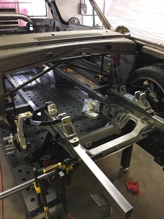

After driving my 340-powered '66 Valiant (with 6-cylinder torsion bars!) from 1972 to '77, then swapping the 340 into my '65 Barracuda and driving that one with torsion bars until 2015, I looked at all possibilities, including all the brands mentioned in this thread as well as a complete upgrade of the torsion bar setup. There are a lot of great features of the T-bar system, but ultimately my decision to go with a 3rd gen hemi was the deciding factor in my suspension choice. We are not quite there yet, but I will be interested to see what happens. I am using Detroit Speed's "Alumaframe" system; this one is designed for an early Mustang, but with new frame rails by Hot Rod Chassis and Cycle, it mounts like it was born there, and nobody has to know I have Ford parts. Super easy caster/camber adjustment, and plenty of room for the aluminum 433 hemi and headers!

Yeah, the suspension setup wasn't cheap, but considering the fabrication time saved, it might be close to a wash compared to the original plan. I had already bought C7 Corvette components, but sent them back when the Detroit Speed system became a possibility. Oh well, my Mopar was going to be part Chevy, but now it will be part Ford.
All sheet metal will be new. The old fenderwell headers had taken a big piece out of the inner fenders. The firewall was perfect, but the new engine placement called for a new smooth piece. Floor was perfect also, but it was cut out along with the trunk floor to make room for the full frame, roll cage, and independent rear suspension.

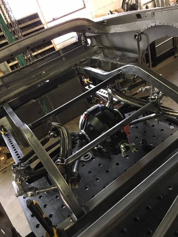

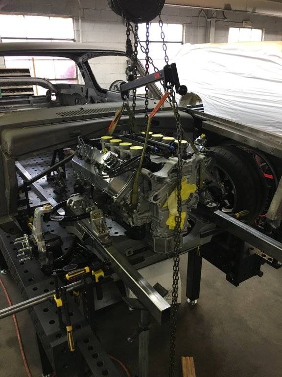

Yeah, I didn't start out that way, but I ordered a new Hellcat engine two years ago, and that kinda set the direction for the build. By the time it became apparent that there was no guarantee of a delivery date for the Hellcat motor and I got my money back, I was too far along to go back to something more conventional. No regrets though--my dyno numbers were 641 hp, 595 ft-lb, which should improve after a little tweaking by Hilborn and MoTec, and I will be a couple of hundred pounds lighter on the front end than I would have been with the Hellcat. I don't think I will catch too much grief for cutting up this car--hey, it was a 273 two-barrel car with an automatic. Besides, I drove it for almost 40 years with the 340, so I think I should be entitled to do whatever I want with it now.
All sheet metal will be new. The old fenderwell headers had taken a big piece out of the inner fenders. The firewall was perfect, but the new engine placement called for a new smooth piece. Floor was perfect also, but it was cut out along with the trunk floor to make room for the full frame, roll cage, and independent rear suspension.View attachment 1715044879
