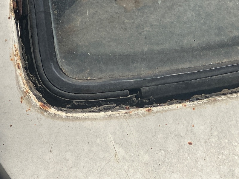

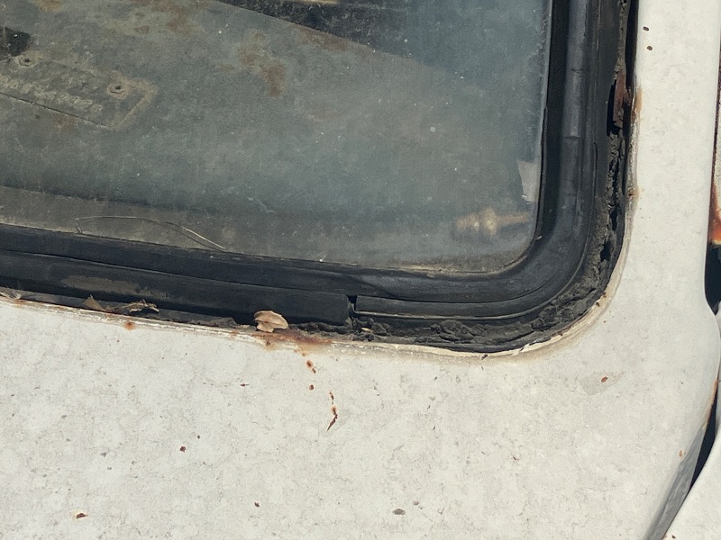

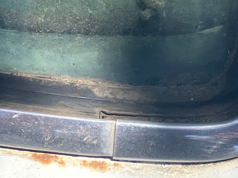

The car I am working on is a 1972 model. It has a built in folding flap/lock strip along the bottom ONLY.
The separate locking strip fills the groove on the top section of the gasket, the sides and a couple inches along the bottom, butting into the folding flap. Aftermarket gaskets seem to use the separate locking strip the whole way around the gasket.

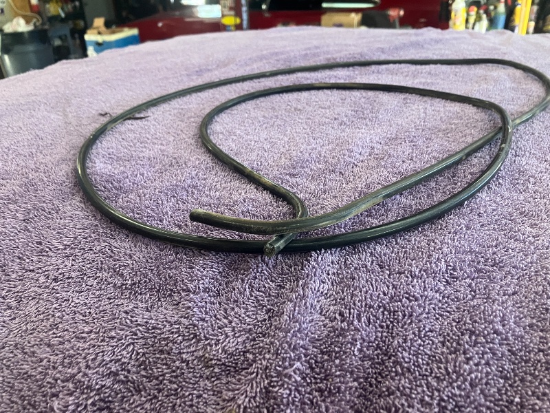

Here is a 1976 Dart Lite:
It looks like the same design here.
If the aftermarket defaulted to the full separate locking strip, this would indicate that this gasket is an original. Next up, a 71 Duster I also have out back:
It looks like the others I have here.
What got me curious is that I have a gasket here that seems to have the same shape of a stock one but it has a groove for the lock strip all the way around. So far, I can’t find any numbers or marks on it. I’ve been guilty of dismantling cars thinking that I’ll remember the parts and their application but I’m having trouble with that.

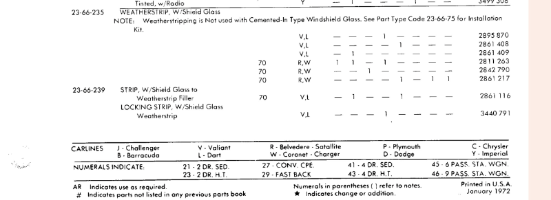

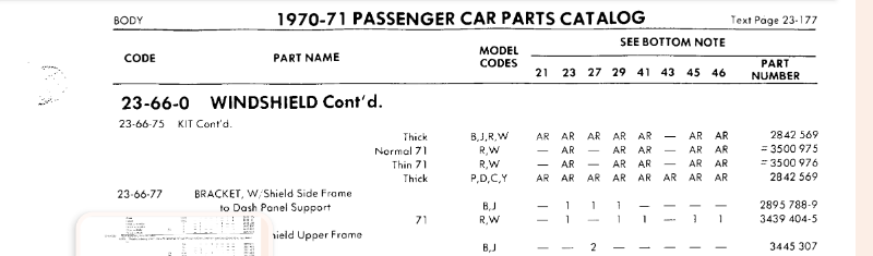

70-71
72
73
74

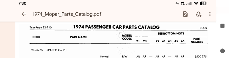

My Mopar doesn't have 75 or 76 parts book
Once I knew the part was 23-66-235 it took less than a minute to find it in the next years parts book.
And typically the PDF page number will be within a few pages of the previous years parts book PDF page number.
