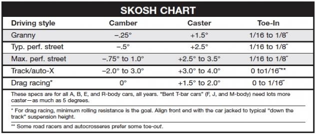

Below are alignment specs to use with modern tires (stock specs are trash) and the instructions for the Moog 7103 bushings to get maximum caster.
