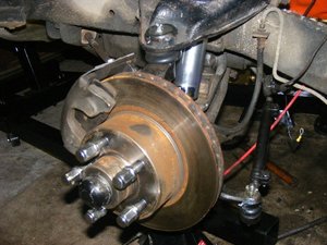

I used a pipe wrench to crack mine loose,then opened up a pair of vise-grips to work them out.Not the best route,but worked with what I had.My threads for the UBJ,s were looking alittle worn,so I tac welded them on 4 corners.This will help when the frontend comes down.TeeHee:toothy10:
