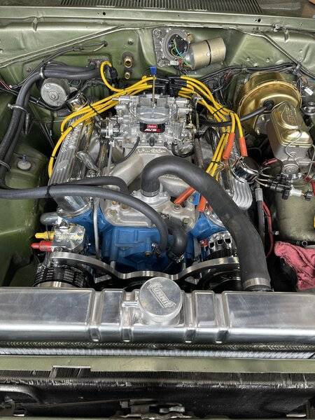

Hi guys, I have a 408 Stroker in my 72 Swinger. I gave a 489 rear end with 3:73 gears. I’m pushing 3500 RPM at 65mph. Not good! What’s the best gears for both street and freeway? 3:23’s or less? Thanks for the help!

Help! I’ve got a 8 3/4 rear end with a 489 case and 3:73 gears. I’m pushing 3500 RPM at 65 MPH. That’s not workin for me. What should I put in there? I’d like it to be snappy on the street, and I’d like to be able to drive it on the freeway. I gave a 408 Stroker with a 650CFM carb. What’s the best gears for this? Thanks guys!
