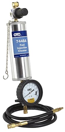

There are kits avail. check around. It'd prob be cheaper to have it done, kit isn't cheap..
Here's the kit I have, as mentioned, block return line, disable fuel pump, attach canister with appropriate adaptors to schrader valve, turn on the can, start vehicle and run till it quits, return to fuel..
It works very well, in some cases, nite and day difference..
