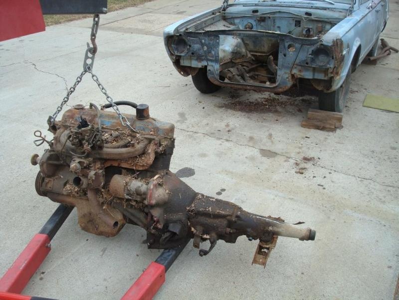

It goes really quick if you take the engine and trans out together. I'll post a pic soon of how I hooked mine to the hoist.
I hooked the chain up to the raised boss on the head by the intake, then the other on the front where the thermostat housing was, just ran a bolt in it and it came out nice with the trans.
