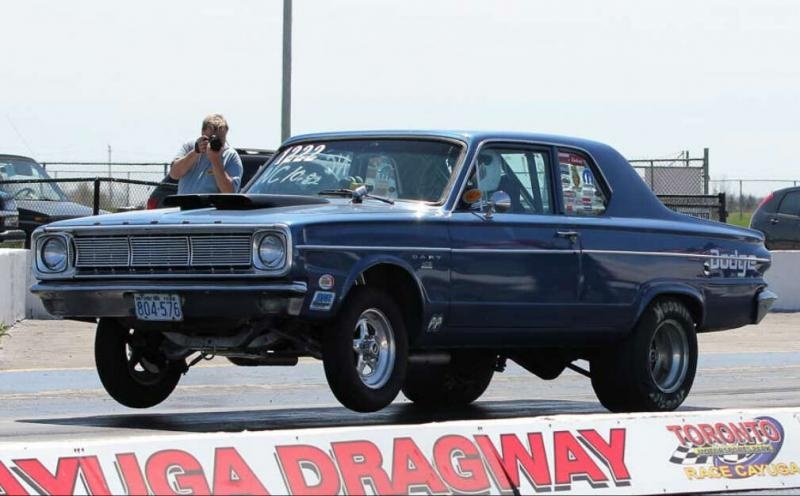

Just an update since going with a Transbrake.Leaving at 3000rpm off the brake,my car is back to porposing.I need to drop the setting on the rear shocks from 5 to 1 and maybe take 1/2 a turn of preload out of the bars(set at 1 full turn of preload now)With the transbrake my best 60ft has been 1.48.Still off from the 1.44 footbraking.Will post results next week.Pic of my car leaving on the T-brake.
@pettybluedart.Your car looks good. Mine was launching, then going out about 30' and spinning.If you bolted the rear shocks on stock, look to see how much travel you have. Mine only had 1/2", so they bottomed out.I made some shock extensions to lower them about 4". It made all the difference in the world.
